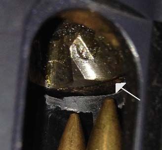

tried the two I bought out tonight and they didn't really cooperate for me with Norinco ammo, I should have brought another brand of ammo to test em with too, The rounds would get pushed forward and hit just below the feeding ramp, If I pushed the mag forward from the back side it would lift it just enough so they would cycle, I know the norc ammo has a tenancy to do this with other 10 round pistol mags as well. I'll try some American Eagle out sometime this week too
Excellent photo, if you take the upper and lower apart, you'll likely see that where the barrel extension fits into the upper receiver there is grooves that are intended to line up with your barrel extensions feed ramps and I can see on your picture and I've highlighted. You'll feel a noticeable bump there and you can see that's where you're getting a build up of copper from bullet tips jamming underneath the barrel extension. If you are comfortable/confident doing so, and have a dremel with a polishing bit you can polish your feed ramps (on the barrel extension) to improve the feeding from all magazines and reduce this catch point.
It's very common in a lot of AR15's, and as the feed ramps are a mass produced part, the tolerances aren't always exactly the same from one to another. If you're local and want to swing by with your upper I can show you what I'm talking about.
I find it unlikely that its the firearms causing this. I experienced the exact same issue on a DDM4 and an NEA rifle with the ATRS mags, while both rifles fed reliably from every other mag tested. Ammo used was exclusively Norinco stuff, so that could be a source as well. I could be wrong, of course, and ATRS has been offering excellent customer support, so have no fears. Im sure they will do all they can to make it right for ya.
Tried it tonight again again with another AR and american eagle ammo and some of my reloads, It happened with both guns but only when the mag is full, I've had this problem with some LAR mags as well, I don't want to toot my own horn by Iam pretty much a pro with a dremel and plan to take the approach suggested above. and believe it or not the photo is from an Iphone 4s.
Wow..i had the exact same things happening and thought it was a bad batch of ammo..I was running norc white box ammo thru my Norc AR..and using the AT mags as well..
The norc ammo seems to contribute to the problem with its longer bullet length from the cannalure up, On the American Eagle ammo the bullets arnt near as long and give the round a little more room to raise up before it hits.
On a side note, I got out the dremel and did some work to the feed ramps, Its manually function testing great now, I'll go out and shoot it tomorrow and see how it does!
post some pics if you can of what you did as im going to have to do mine as well..looking forward to hearing if it works

Heres the after result of the dremelling, I had a few drinks last night so that's why you can see a slip up!
here's the bits I used, the blue is a fine polishing bit, the red one is a little more coarse and I had to use it to take off a little more material, the second picture is more what the blue bit started out looking like
