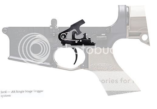

JARD: AR-15 Single-Stage Trigger System
Single-Stage
Pull Weight: 3.5lb
Bow Width: 0.29″
$149
First Impressions: This value-priced trigger had a pretty clean break, but some over-travel. Reset was a bit long, but very distinct. Our sample broke at 3.5 pounds, half a pound heavier than the rated weight. Springs can be swapped out to adjust pull weight. Comes with posi-lock tension plate to secure pins.

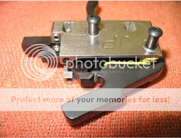

JP Enterprises: JP EZ Trigger
Single-Stage
Pull Weight: 3.75lb, 4.5lb
Bow Width: 0.29″
$260
First Impressions: Long considered a benchmark for single-stage triggers, JP released the JP EZ system for a much easier installation than its classic trigger. By adjusting a few set screws, you end up with the trademark crisp JP feel – short travel, perfect break, and short positive reset. The included adjustable safety removes all slop when on safe. Also comes with two hammer springs and oversize anti-walk pins.

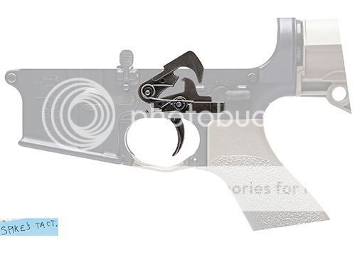

Spike’s Tactical: Battle Trigger
Single-Stage
Pull Weight: 6.94lb
Bow Width: 0.29″
$60
First Impressions: This trigger is nickel-boron coated. The feel was a bit improved over a stock trigger, but was rather rough and heavy. There was minimal over-travel with a long but distinct reset. Comes with replacement pins. On the plus side, it’s the most affordable option among those we tested.

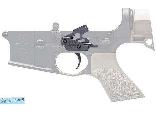

Wilson Combat: Tactical Trigger Unit, Single Stage
Single-Stage
Pull Weight: 3.3lb
Bow Width: 0.27″
$270
*sorry guys, I couldn't find the graphic for this one*
First Impressions: This drop-in trigger had a great single-stage feel, with no take-up at all, a crisp break, and no over-travel. The reset was a relatively short and distinct. The trigger is rated at 4 pounds, but our test trigger was much lighter. Springs on the bottom of the cassette keep the trigger tight. Made of solid bar stock with steel bushings for the hammer and trigger pins. The hammer features a half-#### reminiscent of Wilson’s 1911s as an extra measure of safety. Comes with replacement pins.

Wilson Combat: Tactical Trigger Unit, 3 Gun
Hybrid Single-Stage
Pull Weight: 3.1lb
Bow Width: 0.26″
$270
First Impressions: This drop-in trigger felt like a hybrid single-stage design, rolling a short distance to the clean break. It really felt like a Geissele Super 3 Gun trigger without any over-travel. The reset was quite strong, almost bouncy. Rated at 3.5 to 4 pounds, our trigger measured just over 3 pounds. The trigger bow is also thinner than the other Wilson units. Comes with replacement pins.
Single-Stage
Pull Weight: 3.5lb
Bow Width: 0.29″
$149
Single-Stage
Bow Width: 0.29″
$260
JP Enterprises: JP Original Fire Control Kit *with Speed Hammer
Single-Stage
Pull Weight: 3.3lb, 4lb
Bow Width: 0.29″
$120
First Impressions: This is the original JP trigger that set the benchmark for single-stage AR triggers. There’s a reason JP has a devoted following. If you’re willing to spend some time and effort to install and fit it, this kit will reward you with short travel, a crisp break, and short positive reset – for a reasonable price. Comes with two hammer springs to set the pull weight. Does not include replacement hammer (the JP Speed Hammer pictured here is an additional $60).
Single-Stage
Pull Weight: 6.94lb
Bow Width: 0.29″
$60
Single-Stage
Pull Weight: 3.3lb
Bow Width: 0.27″
$270
