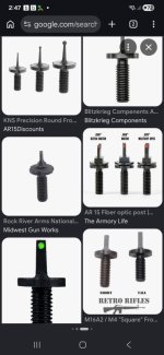

Who in Canada sells different height AR front sight posts. I have looked a bit but figured I’d ask here as the experts probably know more. Need a taller front sight for My Ruger scout. The one on my AR is actually a bit shorter than the Ruger post. 0.040 and 0.060 higher to try out?
Thanks!
There are different heights available. (Google is your friend if you don’t know or understand). wondering who offers them in Canada. I know how to adjust the front AR sight.
Windham Weaponry has a front sight post kit with different heights and Sporteque is a dealer. They don't have any in stock but I'm sure it's worth an email or phone call. Azz####h (extra z's added due to censorship) or Irunguns might be able to bring one in for you.
If the + .40 KNS or maybe bushmaster pins are not enough you probably need to contact Ruger for warranty. AR10 pins might be taller because of the different height receiver but its the Wild West of specs, look for bushmaster DPMS height FSP.

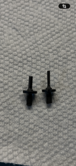

Beltfed was nice enough to send me a few posts to fiddle with, thank you! Bought another on the EE but it was way too short.
Used pure silver solder, soldered two together then cut one base off. Filed, cleaned up. Shot it off the deck after supper tonight, needed a few file down treatments but it works good now. Problem solved!
Still a little long in the pic. The one on the left is the factory one.
