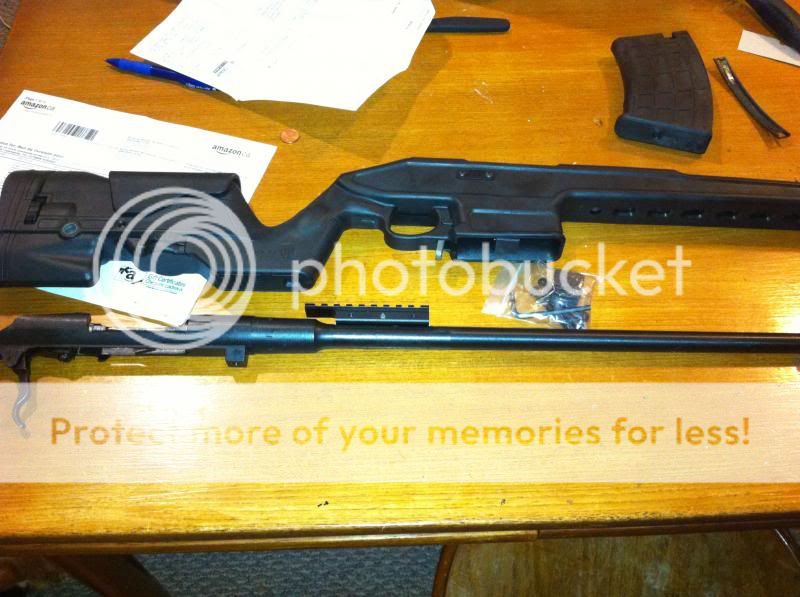

There she is! Cut down by 6 inches, muzzle brake by Henry Rempel and a Timney trigger installed by me:)
Can't wait to try it out!

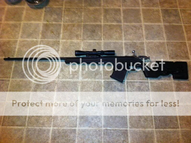

So I took out the Mosin project sunday, and it sure is nice to shoot with that muzzle brake! The kick doesn't feel much more than my .223! There seemed to be a fair amount of vertical stringing, so I'm going to install the barrel dampener and see if I can tighten up those groupings. As is it will be a #####in little scout rifle for watching the bait pile close quarters for black bear this spring. Not super accurate at the moment but I never expected it to be.
Why not add it to the Mosin, I have a cheap good shooting rifle with respectable power, surprising accuracy, and after some filing a very nice trigger pull, what's wrong with making it 1000 times more comfortable. A lot cheaper than buying another modern gun and far more comfortable than any factory rifle I've ever used. Not to mention. This isn't Simo Hayha's personal rifle, its a '41 9130. There are tens of millions of them out there. And either way it does no permanent damage to the rifle. It's just 2 screws.
First shots through the Archangel and new scope last weekend. 1.25-1.75" groups at 100, hopefully this weekend I can load some more rounds and try it further out. And with the home made muzzle brake it feels like shooting a .22. Almost no recoil whatsoever. But I need to double up on hearing protection.
