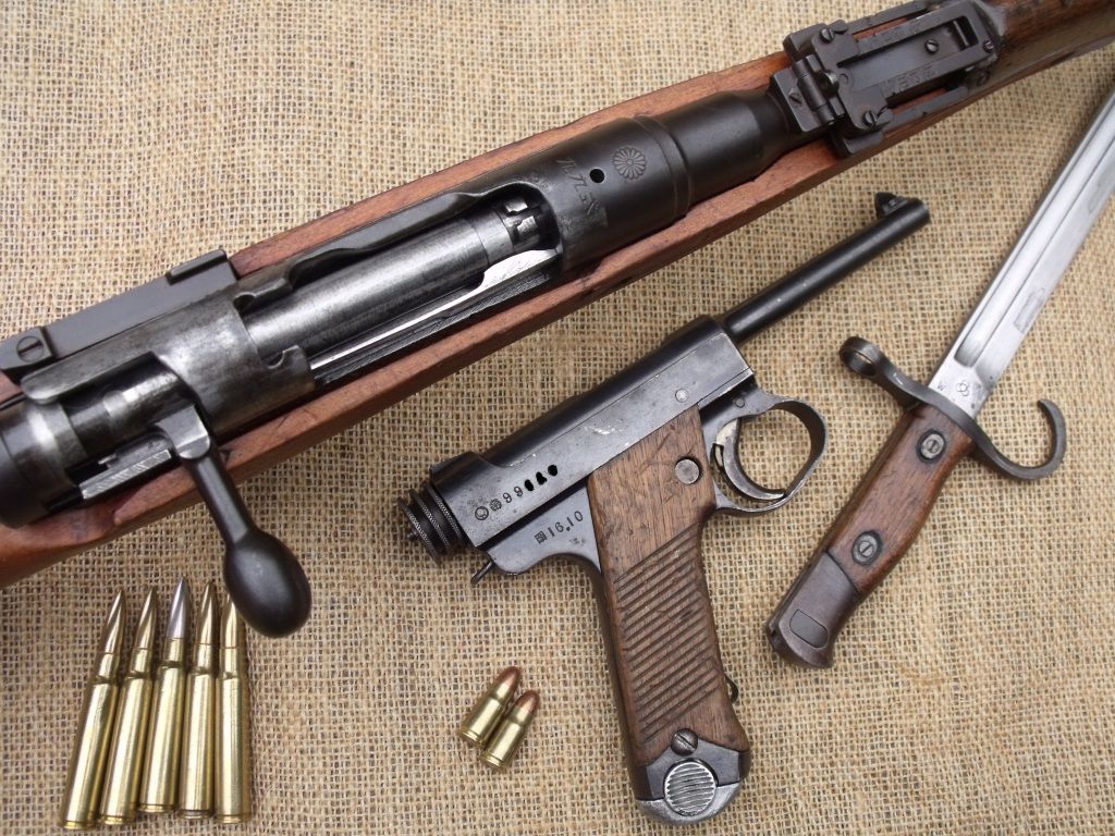

That is the nicest Type99 I have ever seen Joe!
Here is mine - a Toyo Kogyo made around late 42/early 43. Although mismatched it has its mum intact, which to me was important. Has the dust cover as well.

So I finally got pictures taken and uploaded.
This is my first Arisaka and the last addition for my WW2 rifle collection. Initally all I wanted was a matching representation of the Japanese Empire. All my WW2 rifles are very good to excellant condition with all matching numbers so this fit right in.
Since I started collecting info on this one though, I see there are way more variations and options to collect than any other rifle type I have. One could get addicted!!
At least the mum isn't too badly defaced. I think the sling is a repro and in my opinion the stock has been refinished (though nicely done with minimal sanding). Overall a nice example.
The original stock finish on early Type 99's (and most late ones too) was a varnish made from tea tree resin called "Urushi" and it has a deep blood-red tint to it. Honey-colored stocks are generally either very worn or refinished.

I assumed the sling was a repro, it's in far better condition that any other period sling I have so I just put in a box rather than on display. I don't think the stock was sanded but it was lightly stripped and oiled. I believe everything else is original. Should I get a repro dust cover do you think?
If I were you, I'd shells out a few more dollrs and get an original dust cover. The numbers will not be matching, but the rifle is nice enough that I wouldn't hang repro junk on it. Real ones come up on e-pay all the time. Same-same for gunbroker.

Any idea on value for this thing. I don't plan on selling, collecting is an illness and value means nothing to me but the insurance thinks otherwise.
Thanks for everything.
I thin kthat example is worth around the $700-800 mark in Canada. In the states, it would bring around $400.
Agreed with regards to the Canadian value. A few things hurt the rifle (scratched mum, altered stock etc..), but has quite a few things going for it. Overall a very nice rifle that Im sure many here (myself included) would be very happy to own!
Nice 33rd series Toyo Kogyo! For $100 you did incredibly well. Based on the serial number, I would assume it has a chromed bore, but not a chromed bolt face - correct? Your serial number COULD indicate a non-chromed bore though - I think it's in the transitional range.
I posted it's twin at MSC in 2006, a 33rd series T-K, No. 8457, it had a chromed bore but is an earlier rifle. You can see it in the MKL - it cost me a good deal more than $100 though.
Thanks, Claven, it was another case of a guy not knowing what he had. He ended up selling it to me because he "didn't want to take it home." It does have the chromed bore, but the bolt face is not. I don't think this rifle was ever fired due to the entire bolt assembly retaining all of its bluing. It has since gotten a little of it worn off from me working the bolt; I am wondering if it was taken straight from the factory as a souvenier?
Either way, avery nice example of a "transitional" T99!
