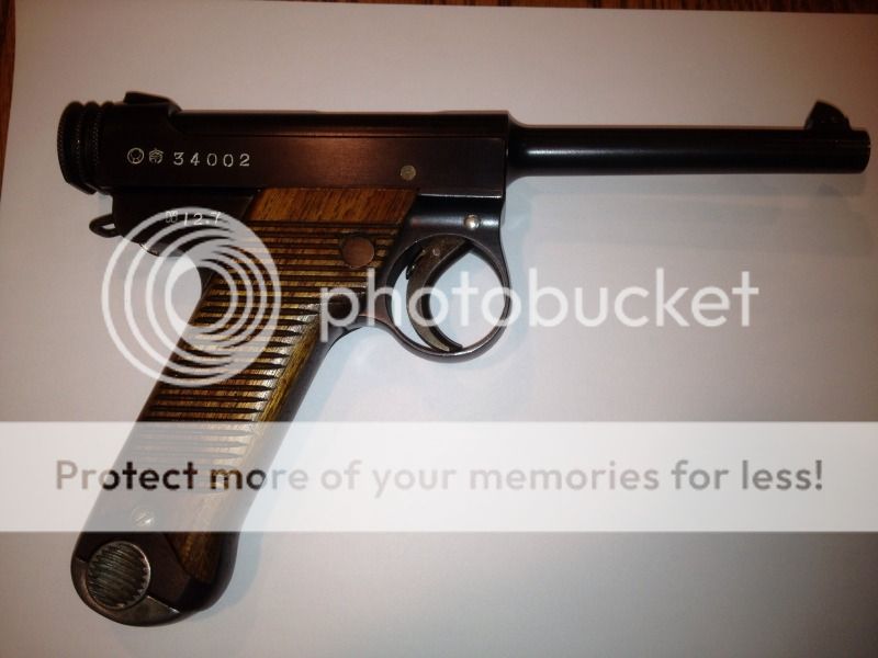

And a couple pistols
Nice one!!!! I have exactly 2 rounds for my Type 14, one original wartime and one postwar:), so I won't be firing it anytime soon!
I have two full boxes of 7.7 though, came with the rifle. Still haven't fired a round out of her yet.
