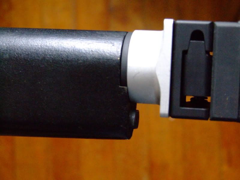

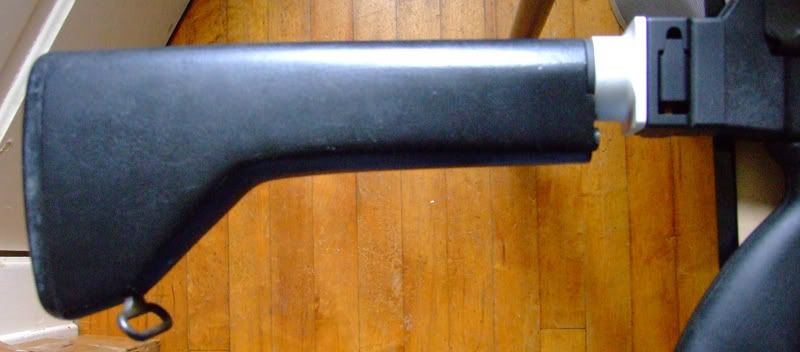

I'm wondering if anybody has mounted, or thought about mounting a Magpul PRS stock on their 180? I have a stormwerks adaptor type 2. I assume I'd need a buffer tube, is that correct? If I call Wolverine, do I just ask for a "buffer tube" for an ar15 along with the stock?
thanks
When you try putting a rifle stock on the carbine adapter you end up with an unsightly gap.
Also there is no way to keep the stock from rotating as there is nowhere for the locating button to fit into.
-Josh
