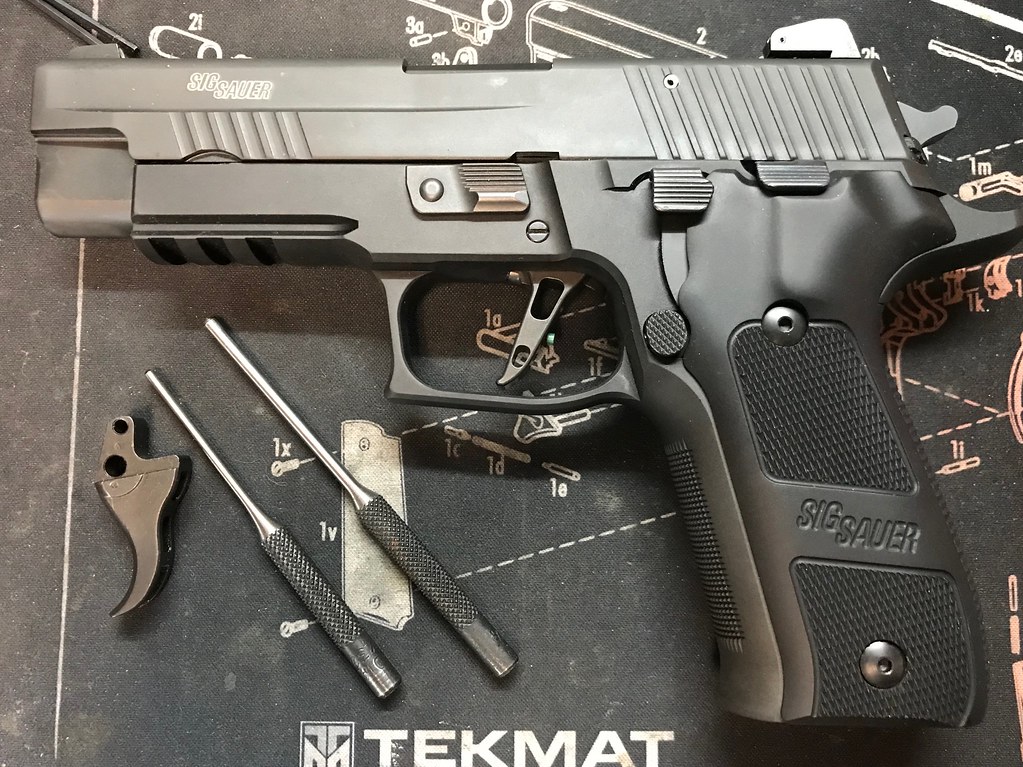

Well, I couldn't get the GrayGuns flat trigger but stumbled on the Armory Craft skeletonized flat trigger. They claim that they were the first to come out with a Sig flat trigger and they ship to Canada. I took a chance and ordered one. Delivery took approx 2.5wks. Could be all the Christmas mail causing the holdup.
Installation took about 90mins of fitting the trigger to remove as much pre-travel so that it reliably engages the hammer for DA but not so much that you start adding back some creep. With an SRT installed and the over-travel screw properly set, trigger reset is stupid short. The end result is a night and day difference over the creepy factory trigger. The pistol feels like a whole different beast.
). Night and day difference plus 10x more comfortable for my trigger finger. Fitment was pretty straight forward with no surprises, even for me
