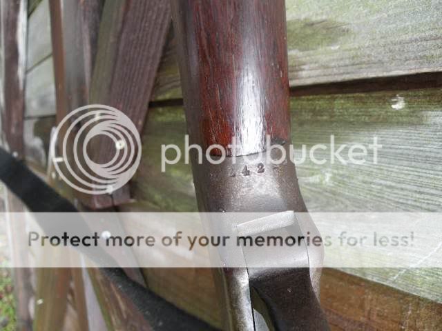

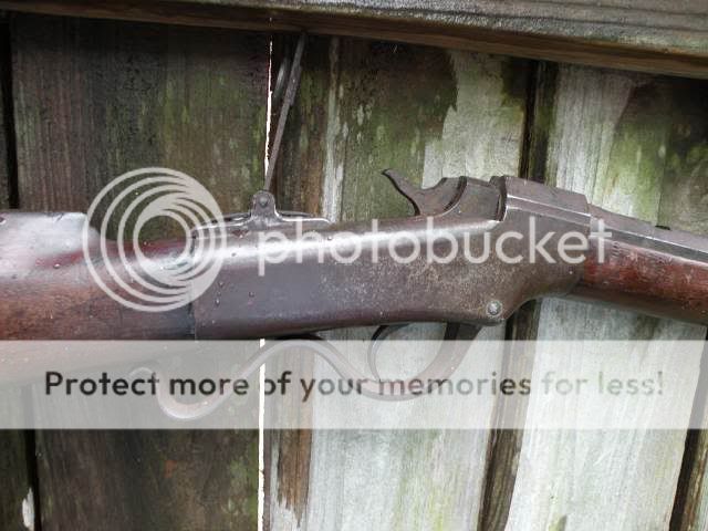

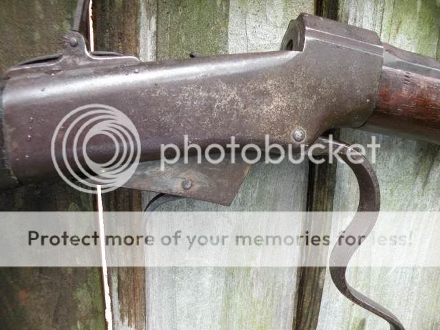

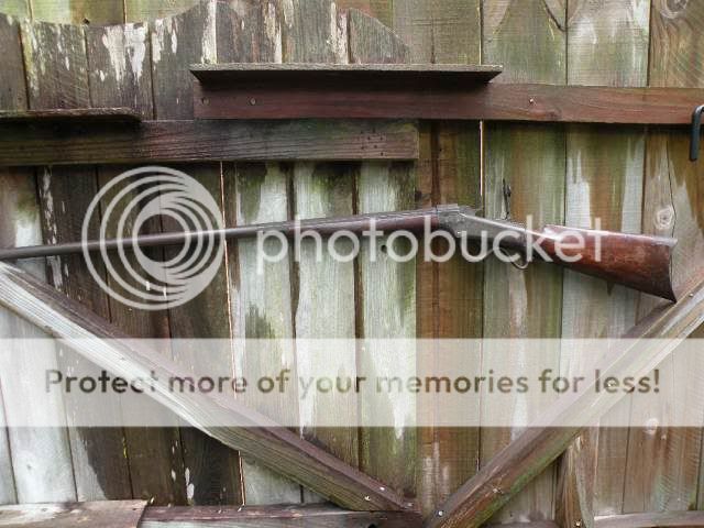

Hey guys, I just acquired a Ballard #3 Gallery rifle from the States. It is an interesting piece for a few reasons. First, it has the 30" barrel more common to the early guns, but has the later-style curve on the top of the action. Also, it is marked on the top barrel flat, "rebored and rif'l'd by J.Stevens A & T Co. Chicopee Falls." It seems this was done by Stevens before they were even a firearm manufacturer! Anyway, it is now in .25 Stevens rimfire. It has an excellent bore, and all is functional. I've lightly cleaned it up, un-seized the gallery vernier sight, and re-oiled. Anyway, I am trying to decide what to do with it. I am thinking of changing it to centrefire (very easy, and does not change anything, just a new replacement part), and re-chambering it to .25-25 Stevens. I had also considered rebarreling it to .40-70 Sharps straight, but the design of the extractor tells me to keep it small. The other possibility is to try and create some centrefire version of the .25 Stevens rimfire, or just sell the gun as is to a collector. Opinions???

looks to have the usual age defects common to these. looks like an octagon to round barrel rather than full octagon as in the #3 gallery. perhaps stevens did more than just rebore. flaydermans has good info on these firearms and they comment that these should have an external extractor mounted on the right side of the frame. i have a few in different models and they all seem to have some unique feature acquired over the 120 years or so. regards, bill

You do indeed have a No.3 Gallery rifle. The groove in the top flat of the receiver is a give away. Nice find. Ballards were manufactured with both forged and cast receivers. It would be very unusual to find a No.2 or No.3 with a cast receiver. Most of the time the cast receivers will have a three line marking on the left side of the frame, while the forged receivers will have a two line marking. To tell for certain if your Ballard has a cast or forged receiver, remove the breachblock. Inside, the cast receivers will have a rough "cast" feel/look. The forged receivers will have a machined feel/look. In addition, the cast receivers are hollow under the barrel shank, the forged receivers are solid under the barrel shank.
The No. 3 had a unique two piece extractor instead of the usual one piece found on other Ballards.
The cast frame Ballards are not as strong as the ones with a forged frames. You might be in for a surprise if you rebarrel to 40-70SS. I would suggest you stick to nothing more powerful than 44-40 loaded with black powder.
J Stevens A & T rebarreld many rifles from other manufacturers of the period. The famed barrel maker, Harry Pope, worked for them at one time. Hope this helps.

Lots of good ideas, thanks guys! I definitely had decided against anything larger than, say, the .25-25 Stevens. It seems that the .22 hornet case could be used to duplicate a .25 Stevens rimfire, in centrefire version, but that does cause a conundrum for the antiue status. If I simply switched out the rimfire pin for one in centrefire, it is not a permanent modification, and should therefore not change the status. I will continue to think on this.
Just wnted to thank you and show all what can be done with some time and a little $$ I took this rifle and changed it a little bought a GreenMountain #2 profile full octagon barrel and new treebone wood and had a fellow shooter and excellent gunsmith put it together this is what it looks like so far with out finnish.

yes 22LR i will be shooting this rifle in our local 22 silhouette matches i will post some pictures when it is all done and has the mva sights on it.
