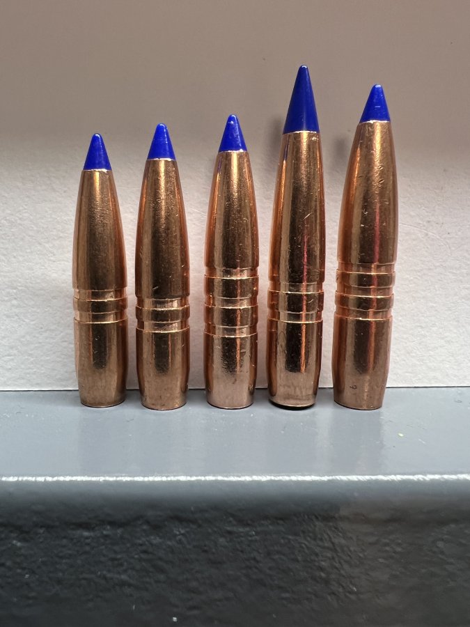

Barnes 7mm LRX 152 & 160gr
I already have a great load for the 280ai with the 168 lrx but will pick up 152 after the season is over. Any idea what both of these will expand well down to velocity wise? I usually use 2000fps as a buffer for barnes but I found for the 150ttsx in 308 that wasn't quite enough.
Barnes 7 mm LRX bullets - 139-145-152-160-168 in order 👍😊
The 160 looks outta place 🤪

.467 and .608 g1 bc's. Ill try the 160 as that's pretty impressive but for the 152 I might as well stick with the 145 lrx. Even the nosler etip 140 has a higher bc than that.
Applied Ballistics Bryan Litz has the 140gr eTip @ .406 G1
Barnes has revamped all their BC's to fall more in line with reality. Hopefully other manufacturers do the same

Any LRX bullet should open up down to 1600fps.
