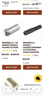

I first dealt with Brownells in 1966. They always have strived to provide the best tools for their customers and their staff are knowledgable.This shouldn’t have problem getting shipped from Brownells
I had the Brownells crowning tools, do not get it, the bits of metal will get between the pilot and lands and scratch your rifling, it will also leave chatter marks, I would get the Manson Precision crowning tools instead, it's worth every penny, ther bore guide expands to hug the lands and doesn't turn unlike the Brownells brass one that spins and the cutters do not leave chatter marks.This shouldn’t have problem getting shipped from Brownells
I've been using the Brownells tools for around 15 years and they work just fine. Maybe the problems you had were user error?I had the Brownells crowning tools, do not get it, the bits of metal will get between the pilot and lands and scratch your rifling, it will also leave chatter marks, I would get the Manson Precision crowning tools instead, it's worth every penny, ther bore guide expands to hug the lands and doesn't turn unlike the Brownells brass one that spins and the cutters do not leave chatter marks.

A rifled bore has 3 different directional facets that need cut when doing a crown and a barrel rotating in one direction cannot be "burr free" cut with a stationary cutting tool...it just cant happen and an exit cut will always either smear or cut a burr or bump in the steel it is exiting...the cutting pressure to the steel is unavoidable and steel is pushed ahead of the cutter. Especially guntecks photo'd cutter, those straight faced cutters all exit a land cut absolutely parallel to the back face of every land it contacts.
