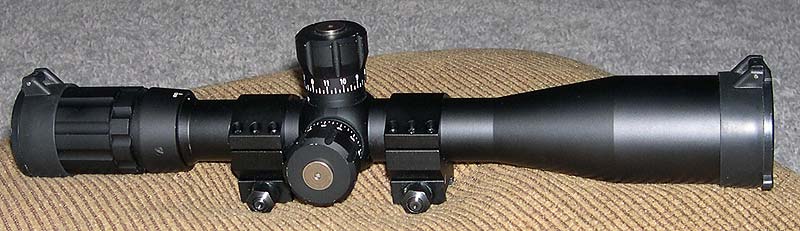

photos from snipers hide

wow, look GOOD, wish they still have that scope...
i'am thinking to put a 10x fixed model on my new build BUT don't know it i will like it, i was to give the 3200 a try, if i don't like the 10x fixed, then, it's cheaper to change it !!!
if i like it, i will switch to a leupold

Nice picture of the scope, which is exactly what mine looks like.

looks like the tasco super snipers
interesting
it looks exactly like the tasco super snipers that were sold by swfa in the late 80's early 90's. at the time, they advertised them as being made to some US military specifications

They may look like the supersnipers, but when you see them side by side, they are definitely of different quality and caliber. Not to put down the supersniper. It is a great scope for a fraction of the cost of the B&L Tactical.
i.m.h.o the clarity of the Tactical is superior to the SS and the adjustment knobs on the Tactical are better constructed with respect to seals as well as the physical feedback and positive clicks when rotated.
Perhaps VViking can comment on his experience with the SS compared to the Tactical.
