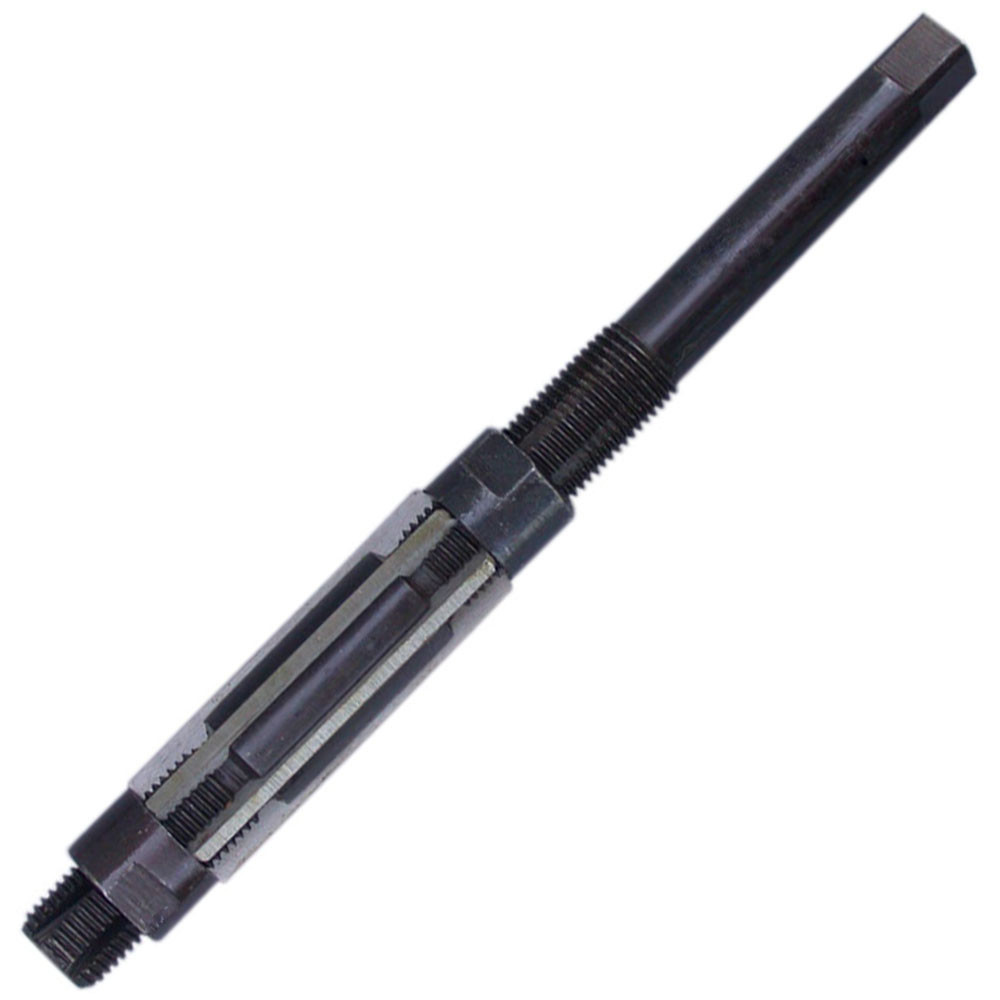

The holes on my BCL 102 are all over the place. Ill drill them all to .275 and install new pins if the crap BCL send me doesn't fix the issue.

So both yours and Dili’s are .241...looking like it is some weird proprietary size. That or they are supposed to be .250 and typical BCL QC. Either way it’s looking like you need to get pins from them (who knows how since they don’t seem to reply to inquiries) or you have ream out the receivers to use anything aftermarket.
