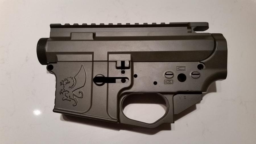

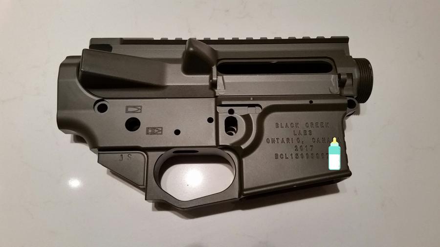

Looks great. Are you happy with the Cerama Coat?
Yes, however some words of advice... Super light coats; I had a couple of small runs and sags to deal with; so I had two moderate weight coats; try for 3 or 4 lighter coats. Unlike anodized or powder coat, I expect that if the finish get's damaged, you can de-grease, redcoat and bake to touch up. Cheaper than farming it out (1/2 -1/3 the cost), but at $50 bucks for a little can, it is more expensive than it should be.
I would use it again; no question. BTW it is much darker than in the photo; must be the flash that makes it look gold. Gold would not be bad. LOL

The Cerama Coat was super easy to apply. I'm really happy with the Olive Drab. It's a little darker than I expected but I'm digging it. Now to gather some parts! 2018-08-14 21.46.16.jpg

The Cerama Coat was super easy to apply. I'm really happy with the Olive Drab. It's a little darker than I expected but I'm digging it. Now to gather some parts!View attachment 198445
That looks really good. Definitely darker than the green I was expecting. Have you ever done a handguard? I’m still weighing my options for the entire build but I want the handguard done. Looks difficult tho!
