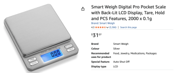

I guess it depends on the scale, I bought two of same make but rated to diff max load and they both show same weight, very fast and show same weight over and over with accuracy of 0.01gn. I'm very happy with them.The problem with a cheap digital scale is they drift as you use them.
The problem with beam scales is they're slow.
The problem with scoops is a lack of accuracy.
I don't think any method is going to make a huge difference at 40yds though.
I also don't know why you'd reload 223 at 1000fps when 22lr already exists and is cheap.
What make/how much did they cost?I guess it depends on the scale, I bought two of same make but rated to diff max load and they both show same weight, very fast and show same weight over and over with accuracy of 0.01gn. I'm very happy with them.
