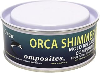

Killer Whale Oil?? LOLI use this stuff. Available online from Amazon.
One can is relatively expensive, if you aren't doing multiple jobs.
Orca Shimmer Mold Release Compound High Gloss Paste Wax
Paste
4.3 out of 5 stars 5
$33.92$33.92 ($0.11$0.11/gram)
FREE delivery Fri, Oct 4
Seller rating: 4.5/5 (21)

I used the "proper" mold release supplied by the bedding manufacturer for over 20 years and then found paste wax was better, and used it for the next 30.You could always use a proper mold release agent designed for epoxies.... Though I have never actually seen/heard anyone on here doing that!!
Good stuff but it hasn't been consistently available. That's why I switched to the Orca Shimmer.https://fibertek.ca/products/honey-...OWfAhK-WTXFYxpkSq68dqUY3QeW_n1N3oHMLKEoxqp2TU
This is my vote one tin will last you a lifetime was recommended to me by a gunsmith. Couple of coats buffed to a shine gives the bedding a mirror finish.
