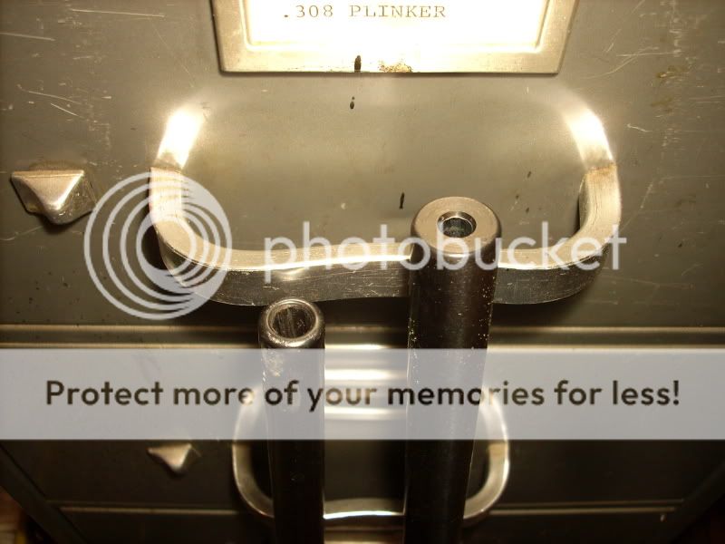

The 7.62 barrel seemed to be free floating all the way. The 223 was touching near the tip.
When I removed the action from the stock, I was surprised to see so much stain in the action it looked like it was applied with a wallpaper paste brush. The finish had a lot of spikes, so these were grabbing the business card I used to test for clearance. When I sanded out the barrel channel using a socket as a round form inside my sandpaper, the card cleared easily. When the job is finished, I will rub some oil finish in the channel, too.

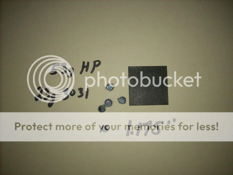

regardless, glad you had some success with the bedding and have gotten reasonable accuracy from them. nice job.
"i also forgot to add that this thread is a perfect example of what a huge difference bedding makes."
Thank you. That was one of the major objectives. As a target rifle shooter, bedding the rifle is taken for granted. In casual shooting circles, it is not always appreciated.
I have some other heavy duty 223 target rifles. This was an attempt to get a super cheap plinker and to see what it can do. Part of the challenge is that it is very light, so it does not shoot off a bag as nicely as a heavy benchrest rifle.
