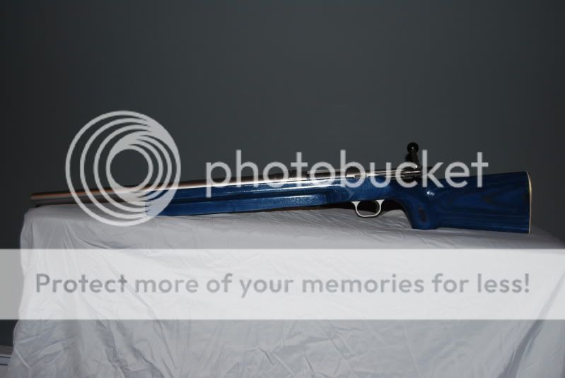

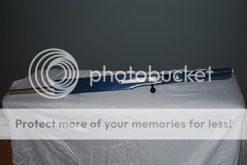

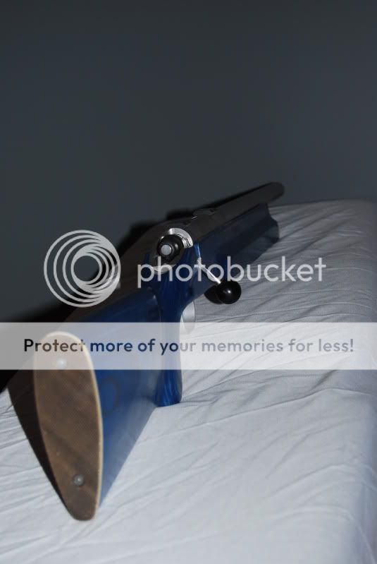

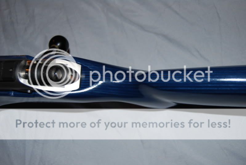

Here are a couple of pics of the finished stock. My wife is starting photography as a hobby, she took the pics
Thanks to all of you for your comments all along this project, and when I have new ones I'll make sure I post them here !
