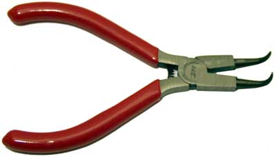

You'll need a pair of C-clip pliers (or a pair of fine needle nose pliers, they should fit nicely into the holes of the C-clip), you use them to squish the gap together and it will fit into the space, then let it go slowly (making sure the C-clip is flat to the washer) and make sure it seats into the little space for it.
