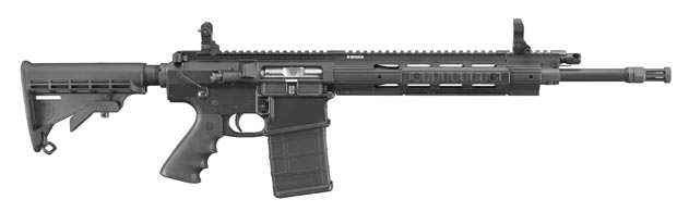

-Sig 716 (short stroke piston system)
-New Ruger SR762
