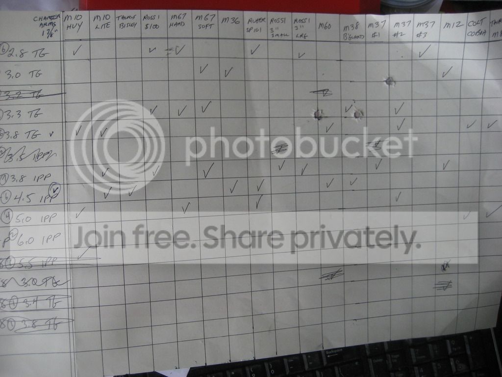

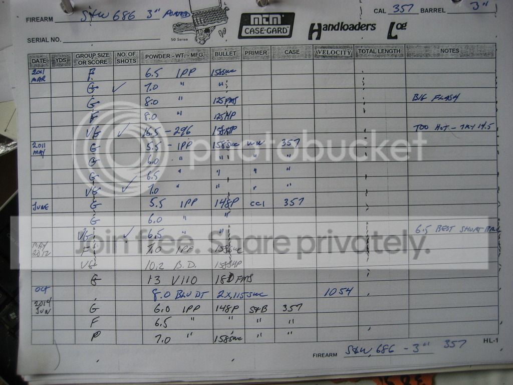

I have found it best to shoot a variety of loads in each gun and to log the preferences. Each load (on the log book page for that gun) is evaluated for grouping ability. VVG, VG, G, F, P. A log page looks like this:
I recently surveyed the log and listed the guns and the various loads and noted the VVG and VG loads. Some loads worked in a lot of guns. Some only worked one or two guns.
My tubs of ammo are labeled with the guns that flavour of ammo works best in.
