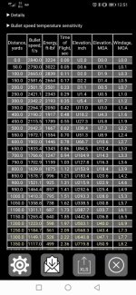

270wsm is also a great choice with proper bullets. Here is a ballistic chart of my old lady's 270wsm loaded with a 180 grain woodleigh bullet. It has experience dropping moose.
