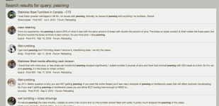

For years I used a small Thumbler's Tumbler - rotary type. Then I tried a CT vibrating thing. It fell apart, so I bought a Frankford Arsenal vibrate, works ok. Then I bought a FA wet/steel pin tumbler. That's pretty much all I use now. I've never noticed any peening that's ...well...noticeable.
It's kinda a Coke or Pepsi
Never - ever had any peanning or damage to any case while wet tumbling. Some guy can screw up anything !
Not saying that it ruins the case... please don't misunderstand.... I simply prefer the quality of the polish more from the tumbler.... Cheers
