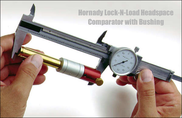

The trouble with measuring cases as they come out of the rifle is that they often take several firings to reach their maximum length. In other words, they may or may not be a snug fit in the chamber.
To accurately assess what length gives you .002" clearance, you need a case that definitely won't fit and work from that measurement.

When I fire my 308 Lapua Palma brass from my F T/R gun, and sample, say, 15 from a batch of 300, the head space may range from 1.626 to 1.6285.... about 0
.0025 extreme spread.
Now, if were to skip a few cycles of of bump sizing then eventually a vast majority of my brass will get stretched out at the shoulder to which most brass sampled will be at 1.6285.
By this time the brass will be very hard to close the bolt (hard to open as well after the shot)....
why would I ever want this (be it at a match or in the field pushing bush) ?
Whereas, if I bump size my brass (everytime) I never have this problem.
Currently, I anneal and bump them all. If and sample 15 brass of the lot, then I will be looking at 1.625 to 1.6255 (maybe 1.626).
Each cartridge is virtually sitting in the
exact same spot in the chamber... that is money... F T/R competitor or otherwise.
At the end of the day, as a reloader, regardless of brass manufacturer, for a new rifle and/or batch of brass I will:
1) take my
very first fired brass, from the 5% sample find the pieces with the longest headspace and use those to set up my sizing die for the bump.
2) (slowly) setup the die until it just start make contact the brass... (bear in mind, at first contact, it may actually make the headspace measurement
longer by a couple thousands)
3) continue step #2 until the bolt (with the fire pin and ejector removed) just starts to close on it own weight (or with very little downward pressure)......
4) stop when #3 feels good
I the case of my F T/R gun, the bolt ran its smoothest with a 0.0035 bump (from the max sample length of 1.6285).
My next 308 chamber might need 0.002 ... or it might need 0.005... who knows.
My point at the end of my verbal diarrhea ......in a large enough batch, some of your brass will probably hit an absolute maximum at a first firing ... use
those pieces to set up your die for sizing for your application.
The others will follow.
