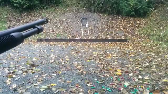

As promised I just came back from a trip to the range.

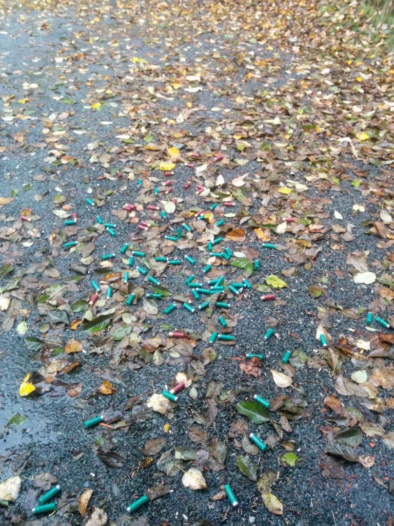

Yes, I was able to put approximately 80-shells (Trap#7's and 00-Buckshot) into the target/burm with little effort.
The 5-rnd magazines worked well, the 10-rnd magazines were very stiff stripping off the top 3 shells, but from then on the ease at which the action worked was comparable to that of the 5-rnd Magazines.

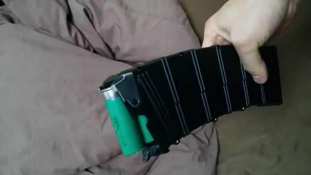

The mags cannot be carried loaded and loosely, shells will pop making need for Saiga-magpouches mandatory (if one ever had a need to carry loaded mags.)

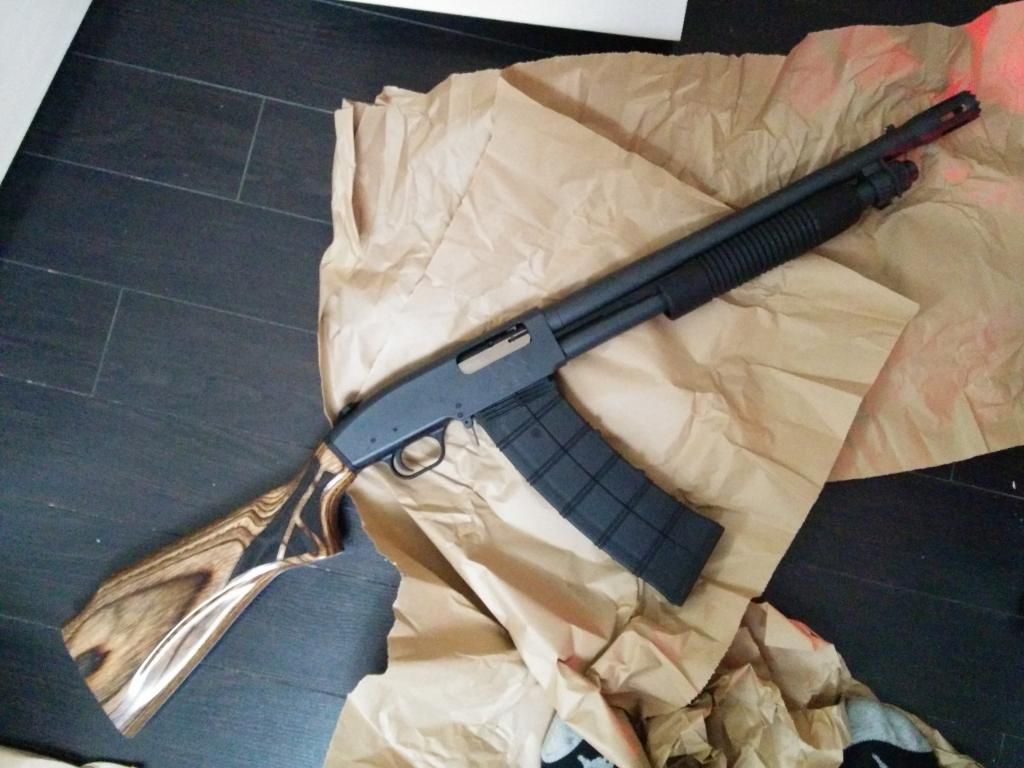

I recently received my Black Aces Tactical - Pro Series 5 Special Purpose (w/Springbok pump assist) and I'm ready to write up a quick, honest, initial review.
First thing is first... change that ATI folding stock!
I had already purchased a Wood-Laminate stock in preparation for this shotguns arrival as I knew I was going to HATE the folding stock that it came equipped with.
Out of the box, the wood is on and things are looking good *at this point I am really excited and happy with my purchase.
I also tossed on a couple GG&G sling plates I had lying around.
Nothing special here except that the rear plate was extremely tight and by extreme I mean I had to hammer it on (carefully) and work away a few thousandths of material (by force) in order to get a proper fit.
No biggie as I rather things be tight than loose anyway.
###Y RIGHT? This is one sweet looking shotgun.

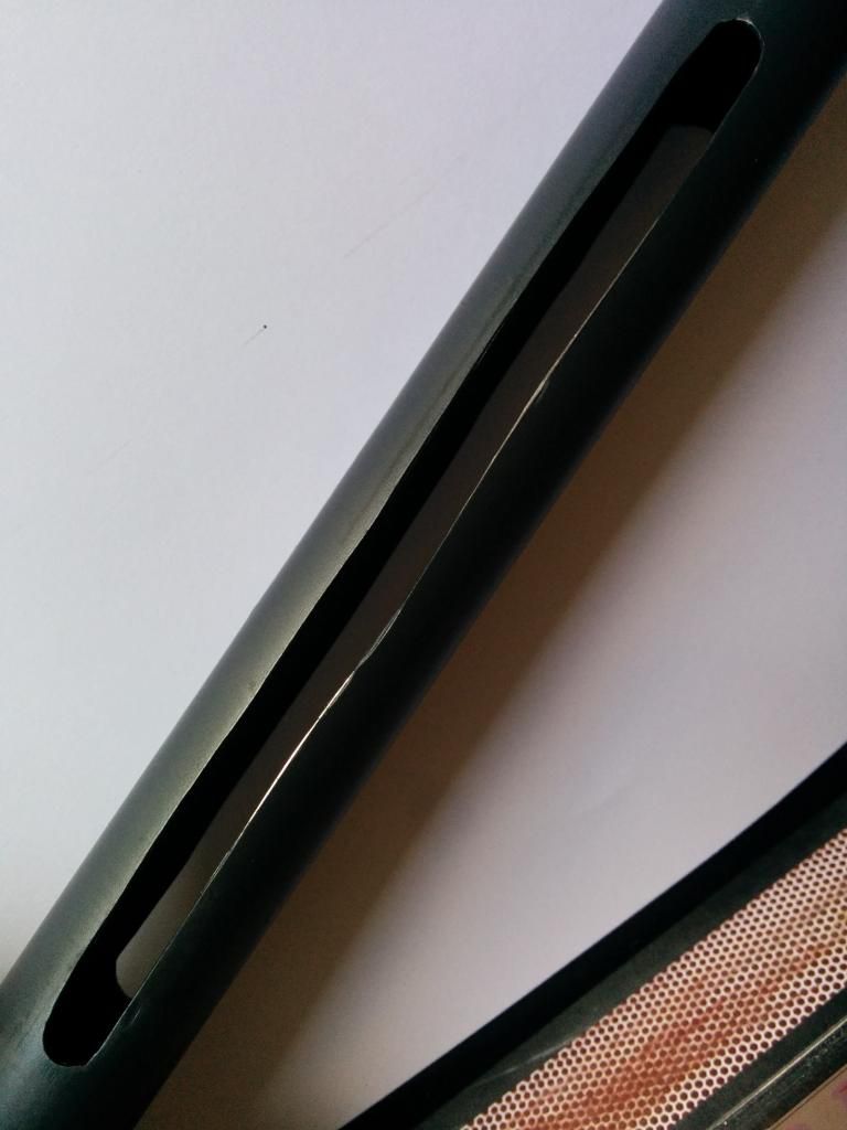

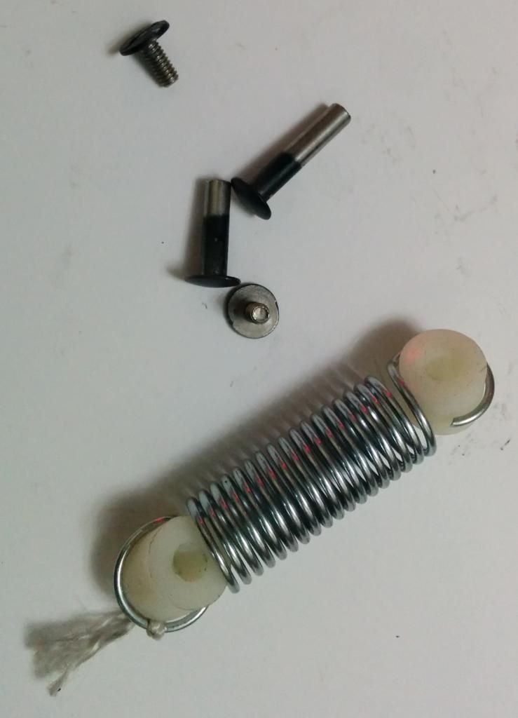

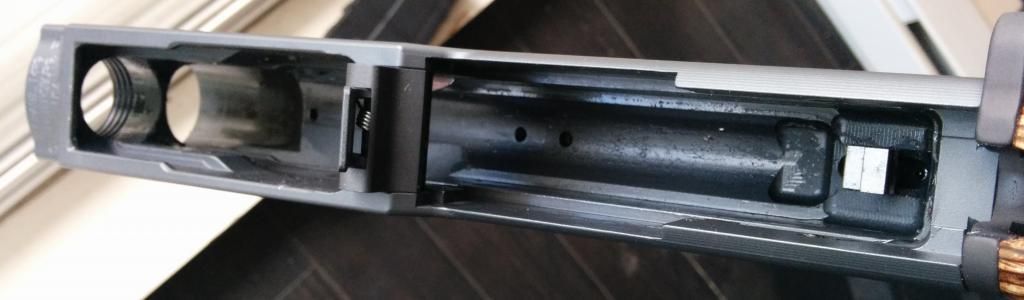

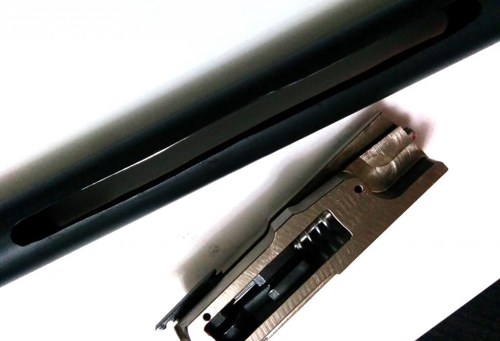

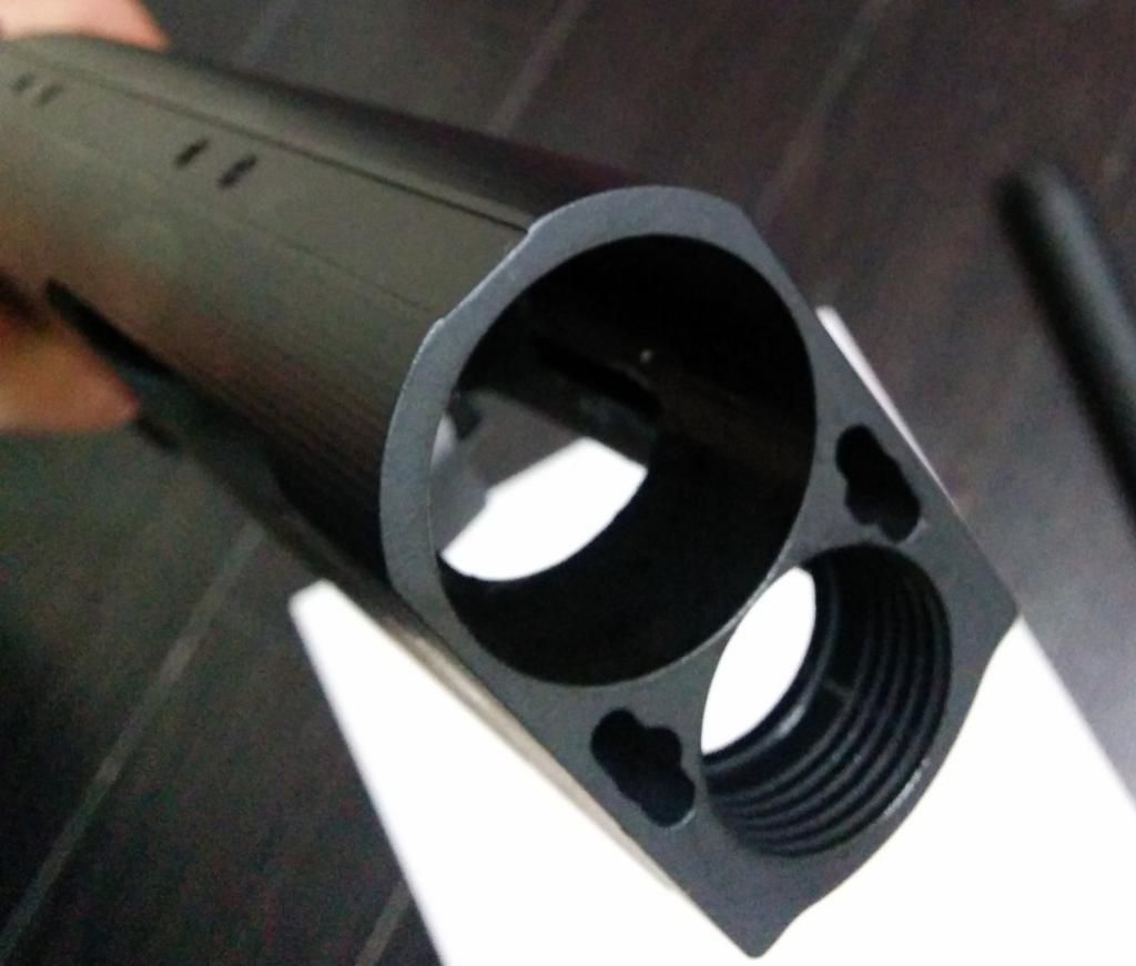

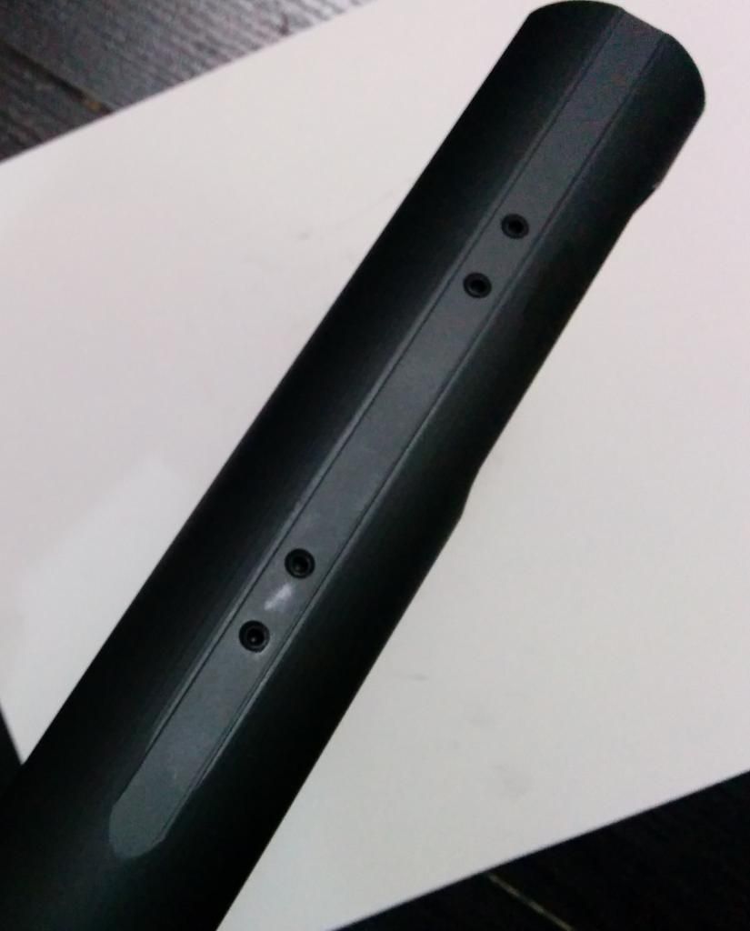

Now for the bad. The SPRINGBOK. Eeeesh! $300 for what looks to be done with a dremel tool - very amateur.
I will offer some constructive criticism and acknowledge that it is a clever idea, but, the implementation is just, bad.
The magazines cannot be inserted on a closed bolt and with no bolt hold open it really begs the question... WHY?!
In order to insert the magazine one almost needs 3 hands; never mind the poor workmanship.

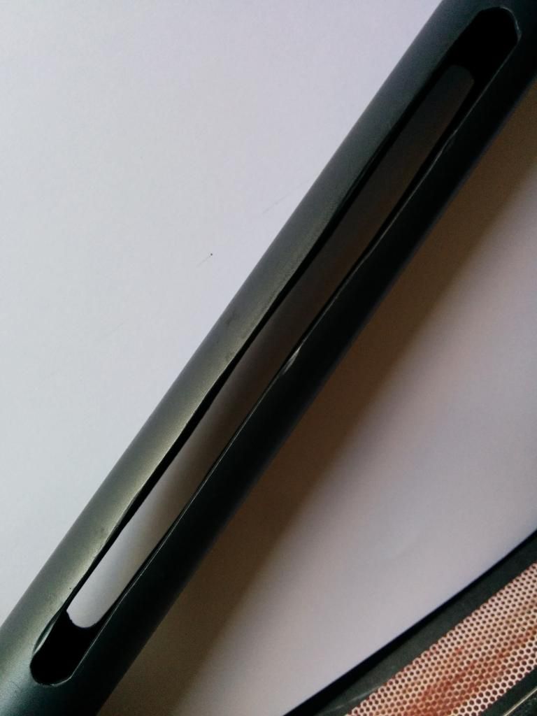

Unsure if you can see it in these pics, but those are the "cuts" in the tube (free-handed ala dremel... let's call it $150 worth):

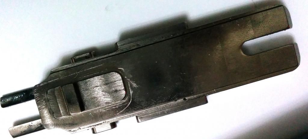

The other $150 worth... the Springbok system:

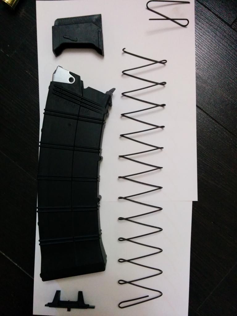

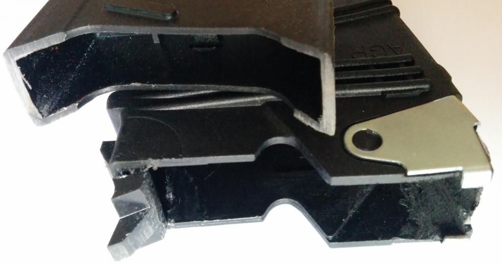

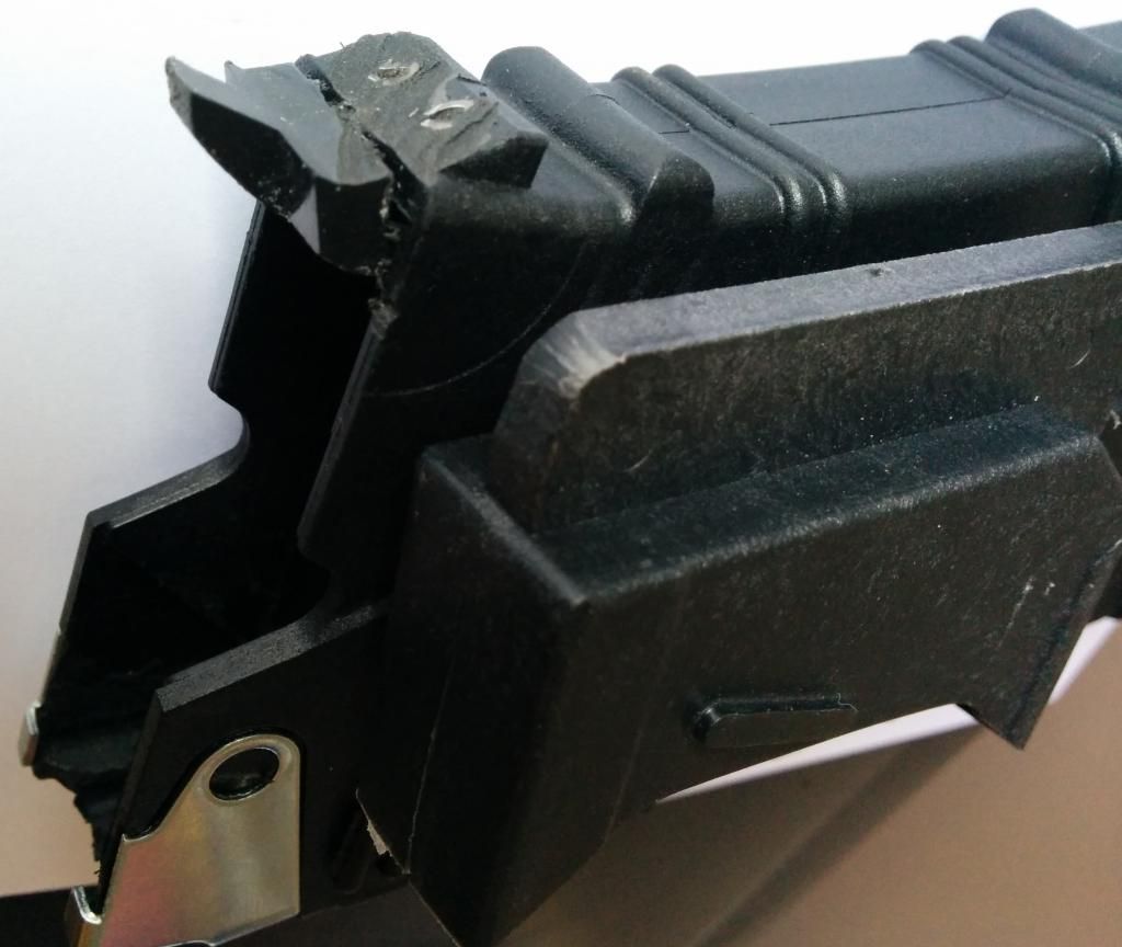

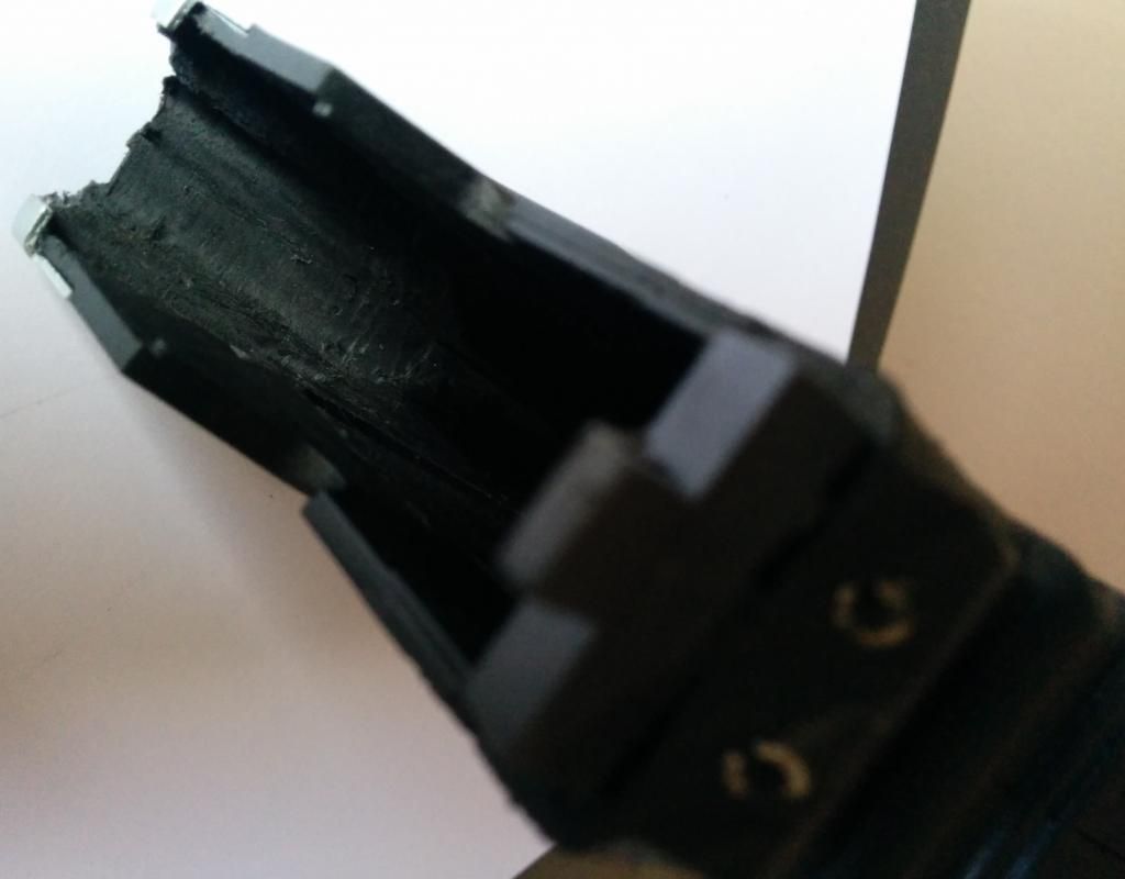

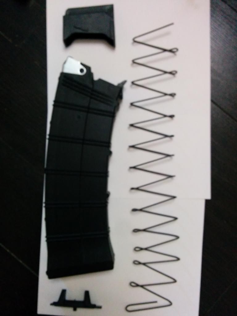

The magazines also appear to be of the same workmanship as the Springbok... very crude. Not uniform. Every magazine is a one-off.
It also appears that all of my mags had the springs in backwards so that I was having problems getting the 10th shell in (in addition to lots of feeding problems); reversing the spring has helped a lot.

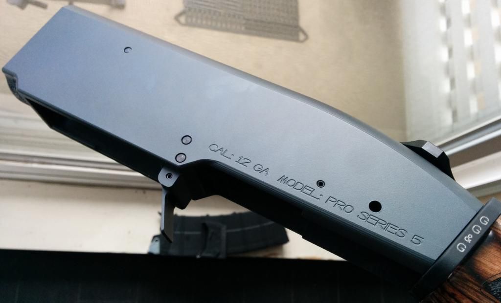

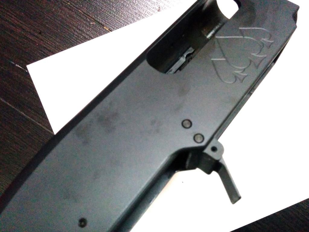

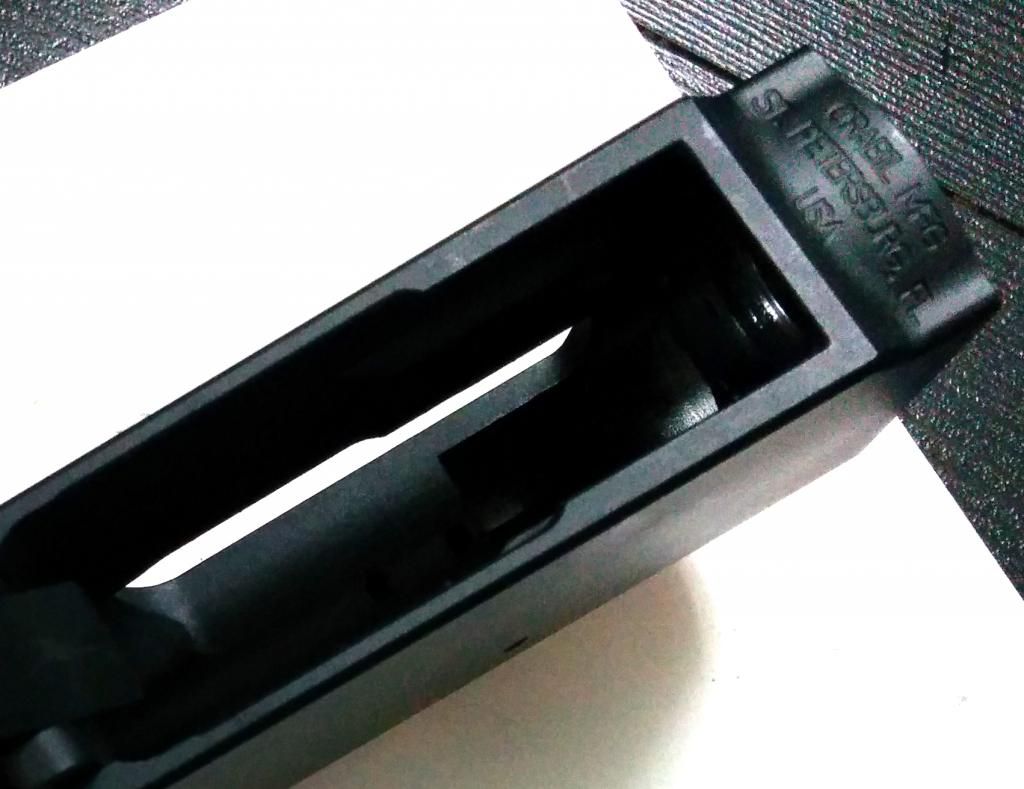

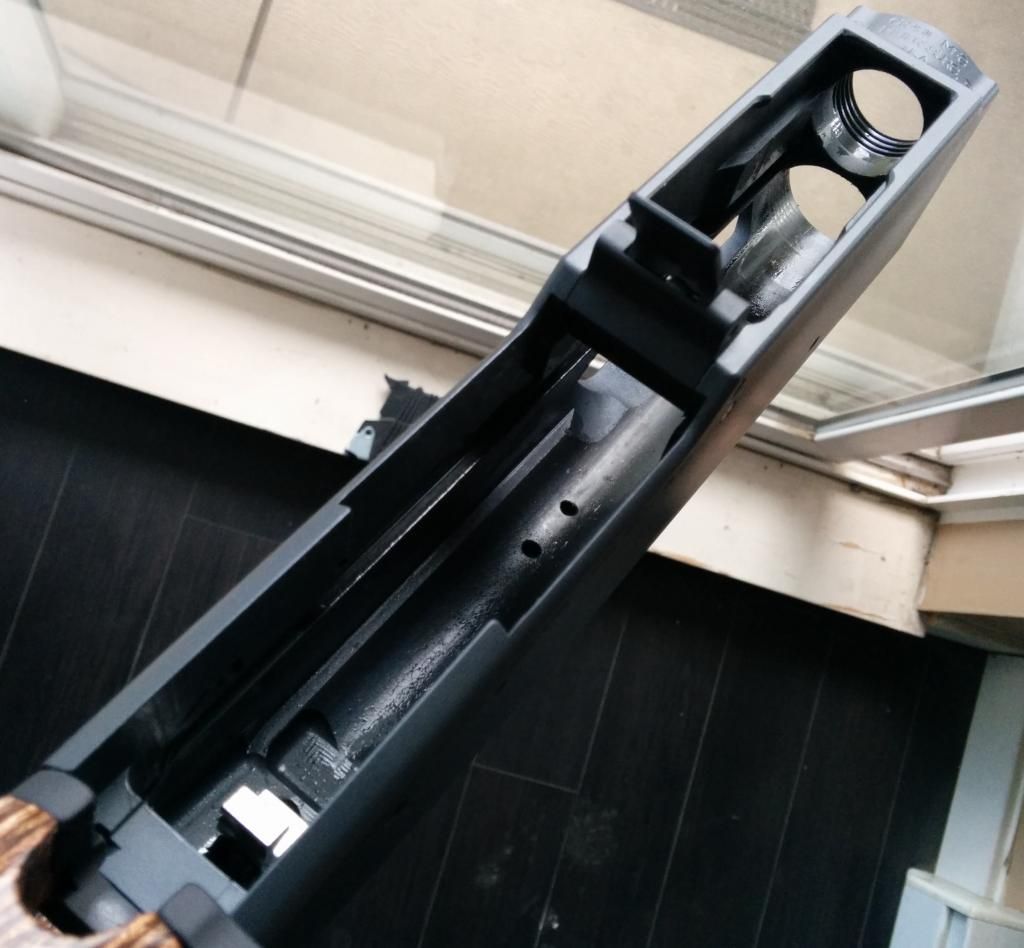

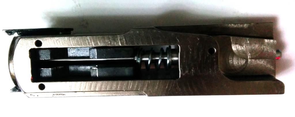

The receiver looks as though it was outsourced by a US company called 'CRABIL MFG.' I also will assume that the bolt and its components are also done by 'CRABIL MFG.'

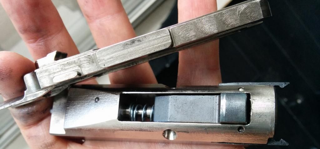

It is very clear that the receiver and bolt carrier group/assembly look like the only things on this shotgun (aside from Mossberg barrel and ATI Stock) that were made by with some professional equipment (sorry Black Aces Tactical, I'm not trying to be a ####, just saying it like it is.)
The paint which was applied by Black Aces Tactical is done well. No drips or fingerprints which I was actually kind of expecting.
