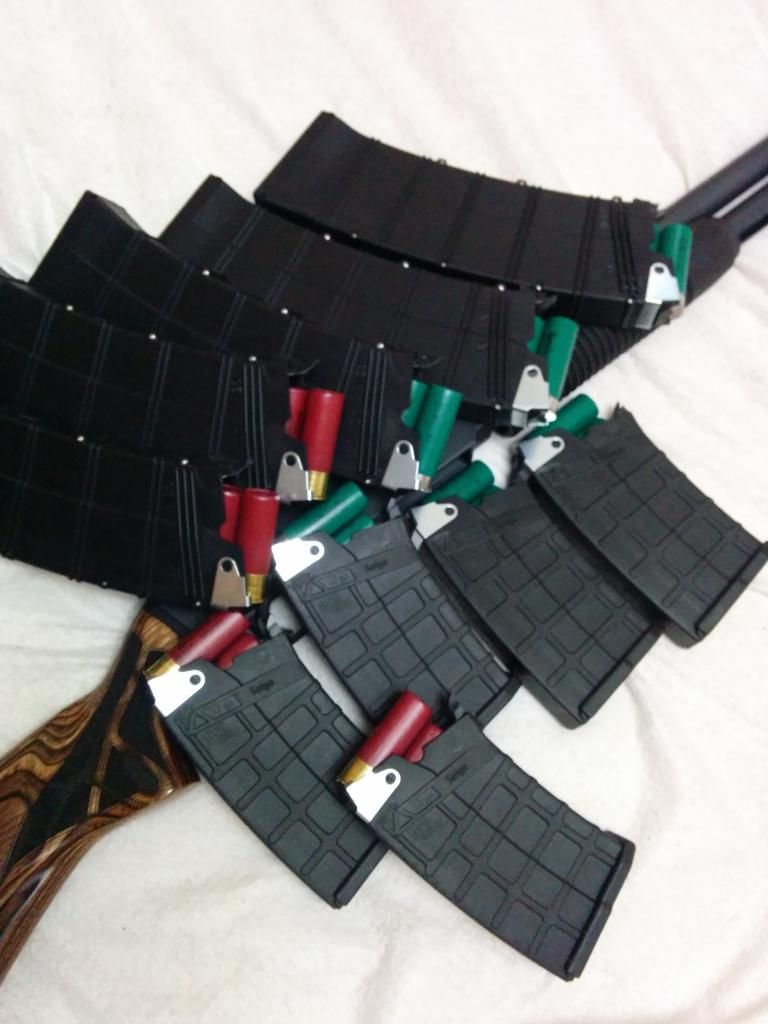

Hi guys,
I finally took receipt of my Shotgun.
Receiver and Bolt carrier group look to be well made.
Springbok not so much; I was disappointed to see uneven lines of a
dremel in the magtube (not milled) and I honestly don't feel it's
worth the $296 you guys are charging.
The 10rnd mags are also unreliable if loaded to max capacity; often
many shells will stagger/jump overtop the rim of the shell below it
causing a catastrophic failure (the bolt will remain locked open.) The
problem only occurs when loading 8-10rnds - 7 or less seems fine.
The 5rnd mags work well.
I want to like this gun, I think you guys have a great idea... but the
springbok should be discontinued.
The 10-rnd magazines should also come with a disclaimer that they only
function reliably with 7 or less shells inserted.

Will take video today after work for final review; I'll also add the final review to front of thread (will keep original below it) so as to give a more "friendly" view on it.
I've also got an opinion on the design of the feed lips which are necessary for the gun to function in its current design which will no doubt cause BAT to blow a gasket; there is a reason why the feed lips on every magazine in existence are roughly 1/4~1/5 the length of the OAL of a cartridge (or shotgun shell.)
Transporting loaded magazines in a range-bag and the feed lips are only 5mm in length (Saiga Mags have 15mm feed lips), well, I'll let you guys guess what happens after a 40minute drive in the car :S
***Magazines are loosely tossed into a large bag*** (perhaps mag pouches would be a none issue - to be fair.)
There is a reason why they are this short though, it's because the BOLT SLIDE would not be able to strip the shell on a non-modified Saiga mag (it'd ride too low and skip overtop). As I said, there are some quirks but in the end, it does work.

With a fully loaded mag (out of the gun) what happens when you drop it or flick your wrist while holding onto it?
Does it:
A) spit all the contents out,
B) The top shell stands up, or
C) Nothing, you can get aggressive with the handling and the shells stay put.
Thanks :)

The 5-rnd magazines worked well, the 10-rnd magazines were very stiff stripping off the top 3 shells, but from then on the ease at which the action worked was comparable to that of the 5-rnd Magazines.

The magazine modifications: My only beef with the mags really boils down to the "machining" used to modify each mag.
The magazines also do not lend themselves well to rough treatment when loaded (if you drop one the right way, shells will spew.)
The mags cannot be carried loaded and loosely, shells will pop making need for Saiga-magpouches mandatory (if one ever had a need to carry loaded mags.)
