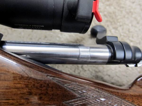

My procedure was to machine the receiver face, the threads and the locking lug recesses square to the bolt race in the action and to machine the locking lugs and bolt face square to the the bolt body and I would machine two dovetails on the rear of the bolt, install two dovetail blanks and machine the blanks diameter down so when closing the bolt there is no up and down movement... this eliminates the upward thrust on the bolt from the trigger engaging the cocking piece and the subsequent falling down of the bolt when the firing pin is released. The machining was always as little as possible to make it true.
This is what the top dovetail looked like on a finished bolt. There is a corresponding one on the bottom side. They engage the action as the bolt closes. Bill Leeper told me about this method years ago, I believe he was the first to do it this way. I call these "Leeper Lumps".
I recall kits to fit "Borden bumps" to R700 bolts. The bolt would cycle back and forth freely, but as the bolt closed, it would be firmly cammed into alignment.
