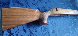

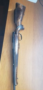

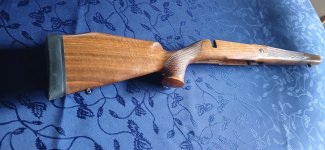

Older Anschutz .222s that were pretty beat up stockwise. Darker look is pre final prep stages and Renaissance wax. Lighter, higher gloss in the second pics. Both are modified Tru Oil processes.
