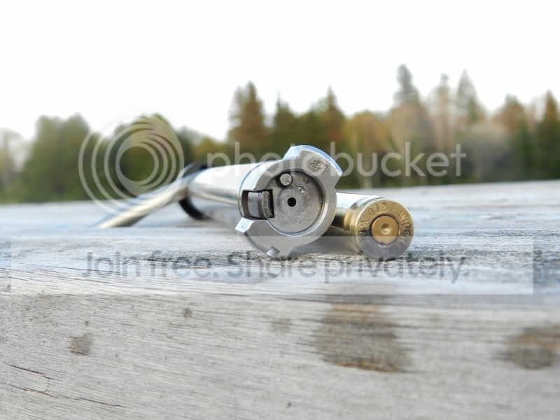

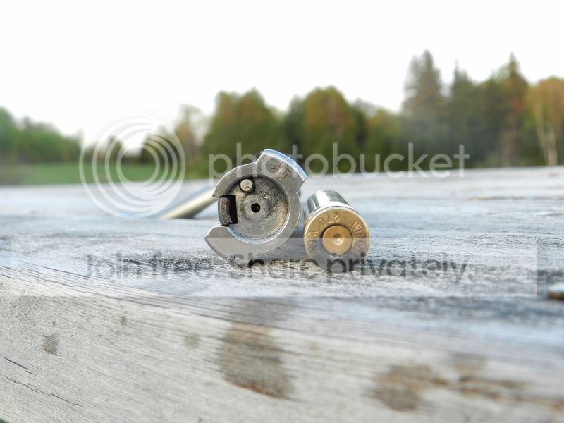

Words can't describe how upset I was when this happened. 4th shot of my first batch of hand-loads in my new to me tikka m695 .270win .... 90gr sierra hp's, with 51gr of varget behind it (winchester brass and primer). I'm relatively new to reloading with only about 3 months and 150 or so rounds under my belt for my .222 and .308. Things looked normal during prep but perhaps I overlooked something???
Couple of questions - what can I expect from rifle going forward. Is it safe and will it affect operation or accuracy?
Also, I'd like to not have this happen again - what could I have overlooked or look for in future to prevent this? :confused::
I cleaned up the black from the bolt face before taking the pics
I have had this happen before - most likely a loose primer pocket. Make sure that when you prime there is a tight fit, this is why I prefer hand priming so you can "feel" fit. As for the bolt face, I didn't have what your picture shows. I would call a local gunsmith to confirm that no accuracy or operational issues going forward, I suspect there won't be.
was the primer seated correctly?
also, are you sure that the bolt face didn't look like that before?
edit: ok, looking at the mark and the brass it looks like it did come from this failure.
I looked at the primed cases as I hand-primed and they appeared OK. There was one case (I only had 4 pieces of brass) that did feel a tad easier to push in than the others but it didn't seem that unusual at the time. This was a bit of eye opener for sure - and a terribly expensive one as well. Bolt face WAS mint before
