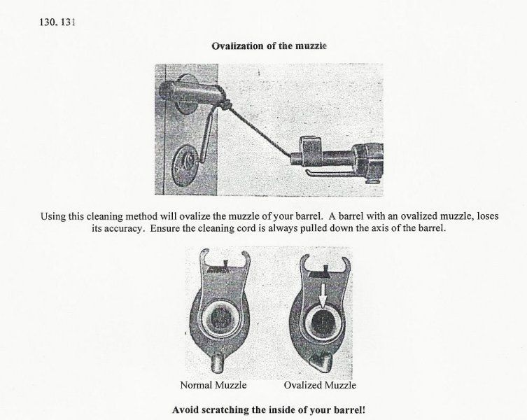

Just google "Shoot to Live." It is a WWII military training manual with all sorts of good information. One of the bits of information in it is a newbie using a "pull through" cleaner on an angle. It can be quite difficult to keep any type of pull through straight when you are pulling it through the bore. Any angle at all and no matter how soft the material it will eventually damage the crown. As Guntech says. No self respecting/knowledgeable competition shooter would or will use a pull through type bore cleaning device.

Using a bore snake occasionally may not cause any grief. Using one on a regular basis will. Even if the fiber the snake is made from seems soft it is still abrasive. If you don't believe it take a piece of nylon or polypropylene rope and rub it a few times against the side of your barrel Watch how quickly the bluing disappears. That blue only penetrates about a half thou so it goes very quickly. Still it won't take a lot to take a few thou off the edge of the crown and down inside for a half inch or more.
It's your snake, your rifle. You choose. Before you do, ask yourself if you can pull that snake absolutely true to the axis of the bore. If you can do that every time you should be OK.

There is only one reason for that muzzle wear and that was improper use of a pull through or dirty bore snake.
Guntech isn't giving you his reason for not using a bore snake lightly. I am willing to bet he has run across this situation on more than one occasion. It is actually something I have come to expect on milsurps, especially Lee Enfields and Garands.
