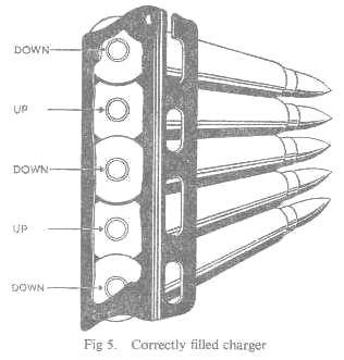

I bought some ammo charger (Stripper clips) at a gun show recently. Does anyone know how to properly load them as the 303 is a rimmed cartridge? I could trial and error, but would rather advice form someone whom actually knows. Thanks.
Doesn't require a video. Baderdog' picture is all you need. Daft enough that they do have to be loaded in a particular way or they jam.
A big part of that was the mil 303 round had a bit of a chamfer on the forward side of the rim, allowing the next round to slide over the rim of the round below it. I have had "rim lock" with commercial 303 brass and it does not ride over it all that well.

Sometimes I don't know why we even bother. Hand out the best information in the world, throw in pictures taken from the actual Manual......
..... and SOMEBODY will jump up and say that it's wrong!
Lord, but the British, Canadian, Australian, New Zealand, South African, Indian, Pakistani, Iraqi Armies (and 50 more) must have been stupid: they all did it the way the Manual shows!
, you can lead a horse to water, but sometimes the damn rifle will still jam!
Concur, I've always found loading the next round with it's rim in front of the one below it never gave me any feeding problems. Doing it in the traditional way (DUDUD) with commercial ammo often gives feeding problems.
