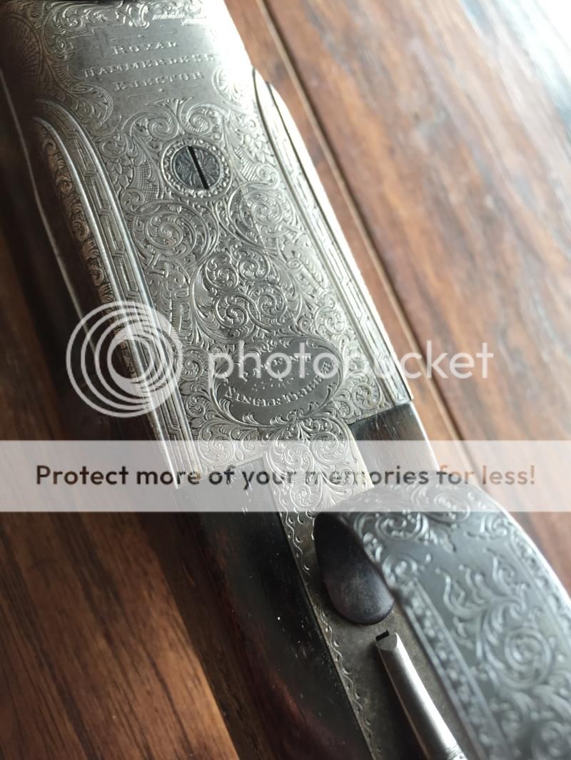

I'll be sure to, want to run the same setup as the stopping rifles wood block tipping. I don't want to put the pressure on myself but from popping primers I doubt I've ever handled anything as fast as a single trigger double that points like she does. Only part I'll be off on is soon, flying back and forth to work (where I shoot) for a good while and I don't trust Air Canada regional baggage enough.
Quite right, it is mechanical and moves to the next barrel without requiring recoil, which I was happy to find, Dogleg had enquired earlier. I too prefer a single trigger and same for my side by side shotguns, I don't mind a double trigger set up, but a double rifle with a single is as fast and simple as a rifle can be. The single trigger option is quite rare and really attracted me to this gun, add to that it being a .375 Flanged mag, a double chambering I'd been considering for some time view as an ideal all rounder and there was no way I could let it pass.
I don't think the single trigger will be the big speed advantage you think it will be. As modest as the recoil of that rifle will be, it still has recoil, and it still takes time to acquire the target, and I can't see how you can acquire the target in less time than it takes to slide your hand back on the grip 1/2" to the rear trigger. I think the only real advantage to the single trigger is that you don't have to adjust your grip on the gun.
As far as being simple and reliable, no single trigger can be as simple in construction as the double trigger setup. The fundamental principal of the double gun, rifle or shotgun, is to have two basically independent mechanisms attached to a single stock. Taking those two independent mechanisms and making them both dependant on a single, complicated trigger mechanism, seems to me to be a step in the wrong direction. As you've said, single triggers on double rifles are rare, and there might be a reason for that. I know about Sutherlands single trigger Westley Richards, and how it still seems to be working today ( although I don't know the last time it was actually fired), but if you did a poll of English smiths, I would wager they get a lot of single triggers back for repairs.
