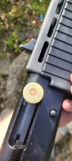

This gun does not work. In its factory configuration, with all the OEM parts in it, it still double feeds, fails to feed, and locks open with ammo in the magazine.

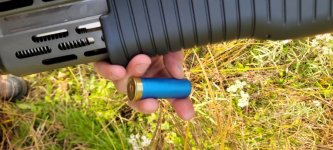

Ammo used was Score buck and slugs, as well as Federal blue box 1 oz 1650 FPS slugs.

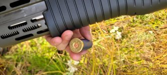

The spontaneous disassembly also continues.
This is the magazine tube spring retainer after only less than 10 shots of interrupted buck and slugs.
Since the gun was kind enough to take itself apart, I went ahead and tested the gun without the spring retainer and replaced the OEM spring with an S&J spring trimmed to 1.5x the length of the magtube plus extension.
The doublefeeds and failure to feed continued.
A different orange plastic follower was used instead of the OEM follower. Same issues.
The OEM follower and spring were used without the spring retainer. Same issues, and now shells were binding in the magtube.
