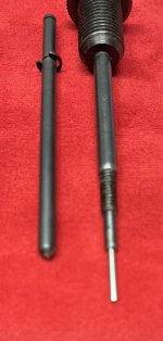

I tried rare earth magnets, thermal shock and a few others, like inertia but the Redding decap for the small flash hole has only a hole in the end and the pin is pressed in so it’s not like a spindal from a normal die. The spindle on the left side is the Redding spindle broken off flush with the end and the right is a standard spindle from a Redding die. Very different!IMG_3191.jpeg
