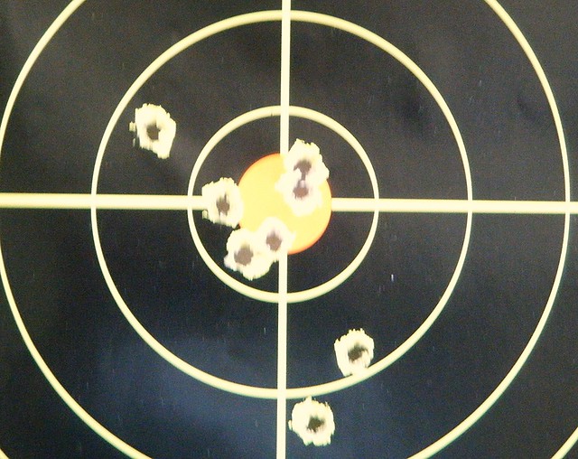

I took mine out yesterday - hadn't been touched since last Season - 10 months ago - Federal 150 gr Soft Point @ 100 meters - the 1st mag (4 shots) needed some scope-tinkering. The next 4 were good enough for me (that's a 1-inch bulls-eye)..... ;)
It's an '81 lightweight takedown, straight grip:

358win pre 81, with a 1-3/4to5 on it.
(Bottom 3 shots were fresh off the boresighter)
