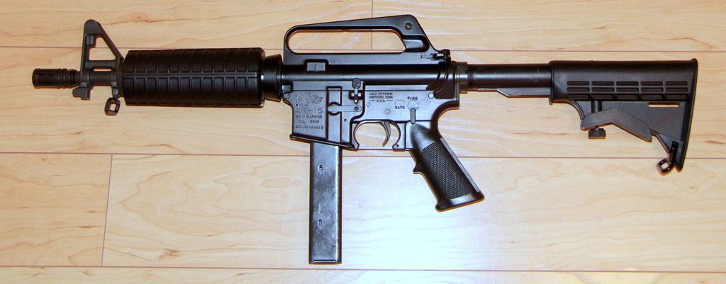

This took me 2 years to build/ acquire all of the parts,
the reason you cannot use glock mags in a reg lower is because of the feed angle from the mag,
using a mag block works however you need to drill a hole in the magwell as so that the mag well block can be rollpinned in place (using the hole you drilled) its not an easy convert back to 556.
you need a dedicated buffer system and bolt, barrel and break.
if you go the colt style way like I did mags are pinned to 5 rounds
if you go the glock style way your mags are pinned at 10.
if anyone has any questions ill try and look back here to help out future builders
building this rifle taught me a lot about the AR platform.
All colt parts except the lower
The lower is a CQ 10 9mm colt lower
This gun runs on colt 9mm AR mags

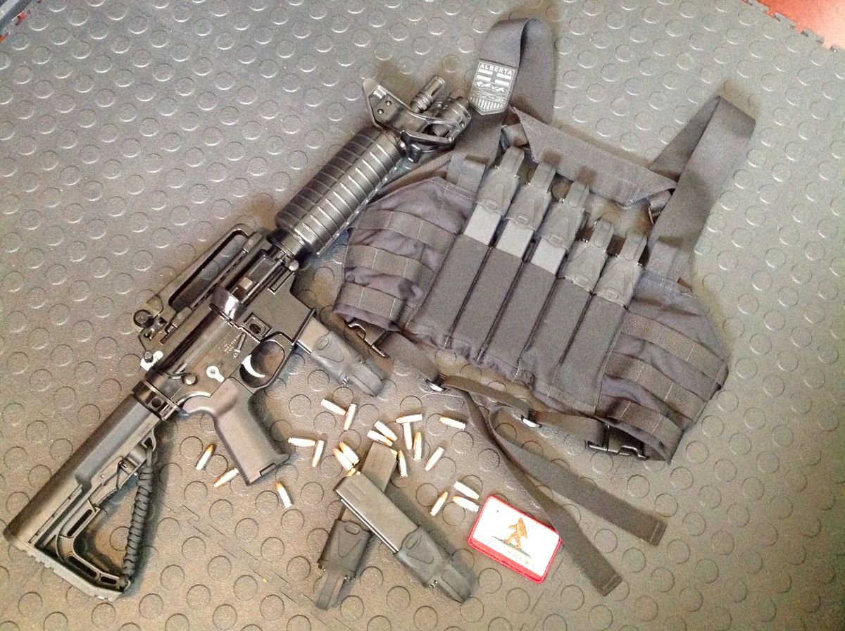

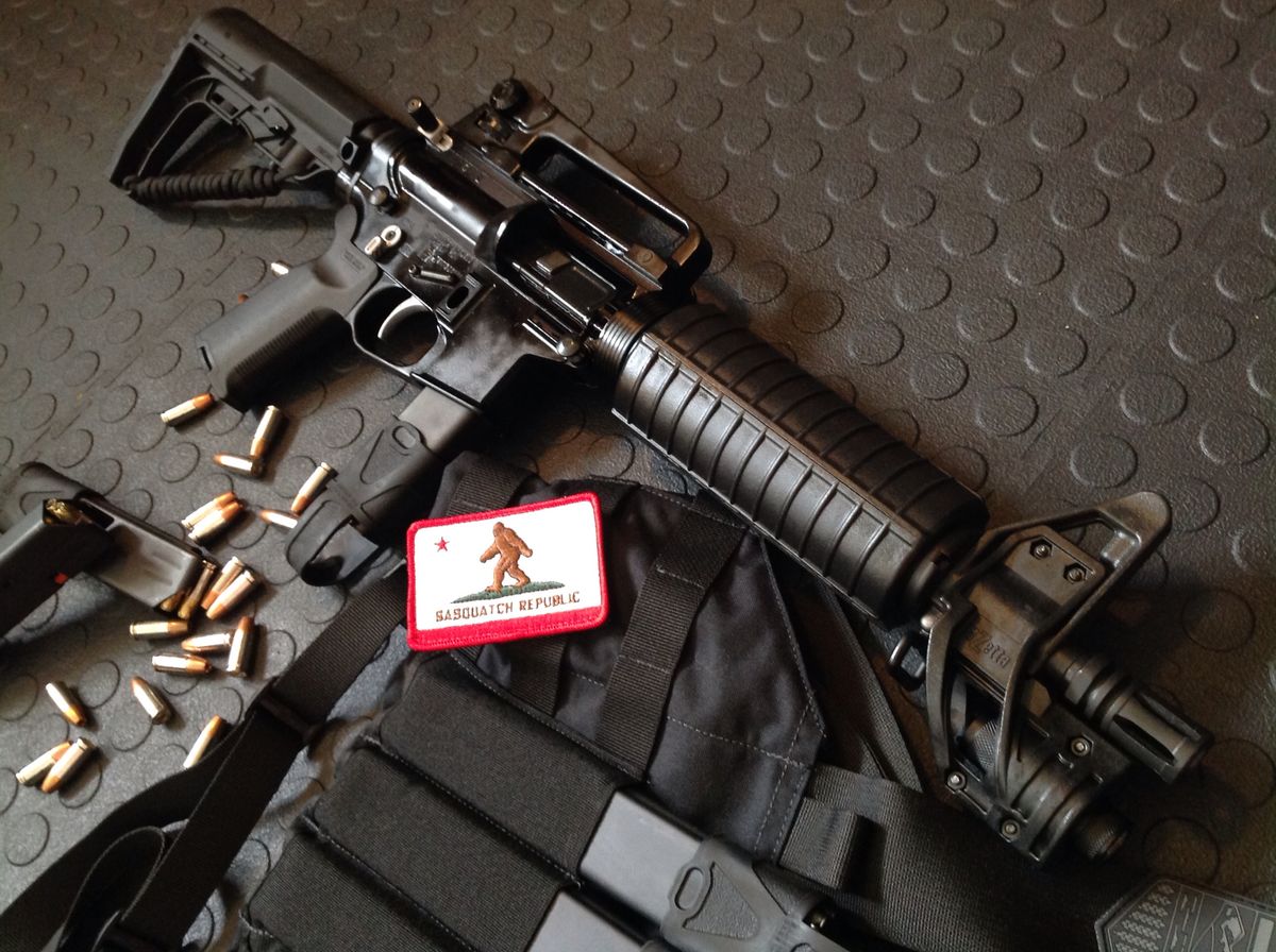

I built my 9mm AR a couple years ago; runs great and is one of my favorites.
I thought about the Glock mag setup, but I like the look of the Colt mag setup better.
-CMMG M4 Upper w/M4 feed ramps
-RRA 10.5 9mm barrel (Front sight tower removed)
-RRA 9mm A1 Flash hider
-RRA 9mm case deflector & ejection port door
-Troy MRF-X 10” Rail
-LMT Charging handle
-Yankee Hill/CMMG 9mm Bolt Carrier group ramped for use w/M16 hammer
-Spike’s ST-15 Multi cal lower w/color safe/semi bullet markings
-RRA Lower parts kit
-RRA Ambi selector switch
-Spike’s 9mm mag block
-Spike’s ST-9X heavy buffer
-Magpul grip and stock
-5/30 steel mags from Irunguns
