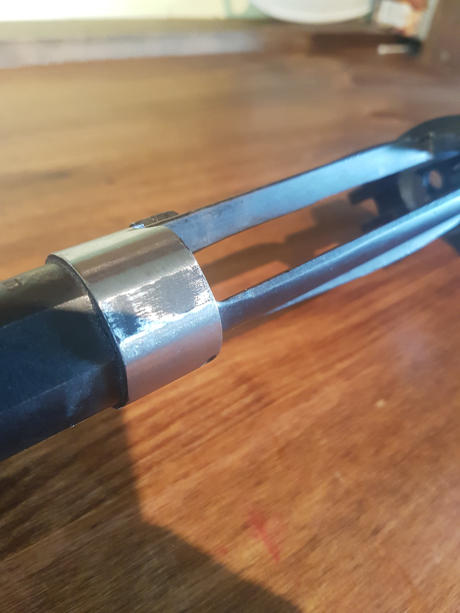

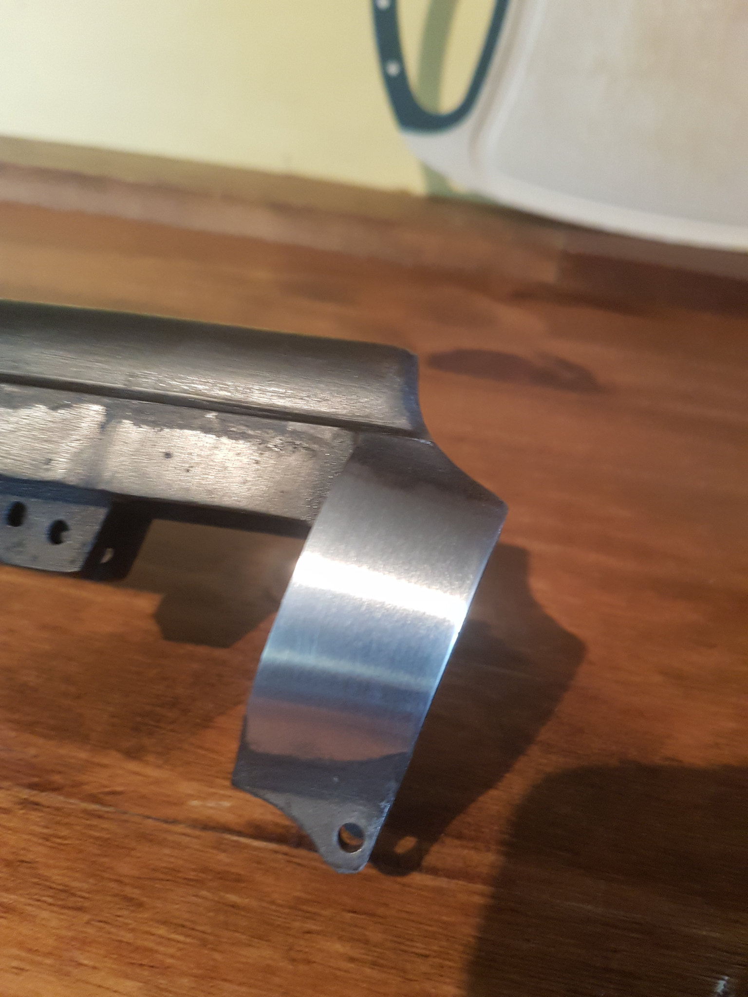

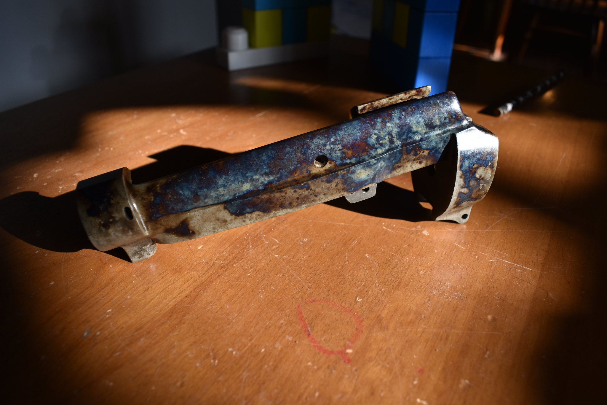

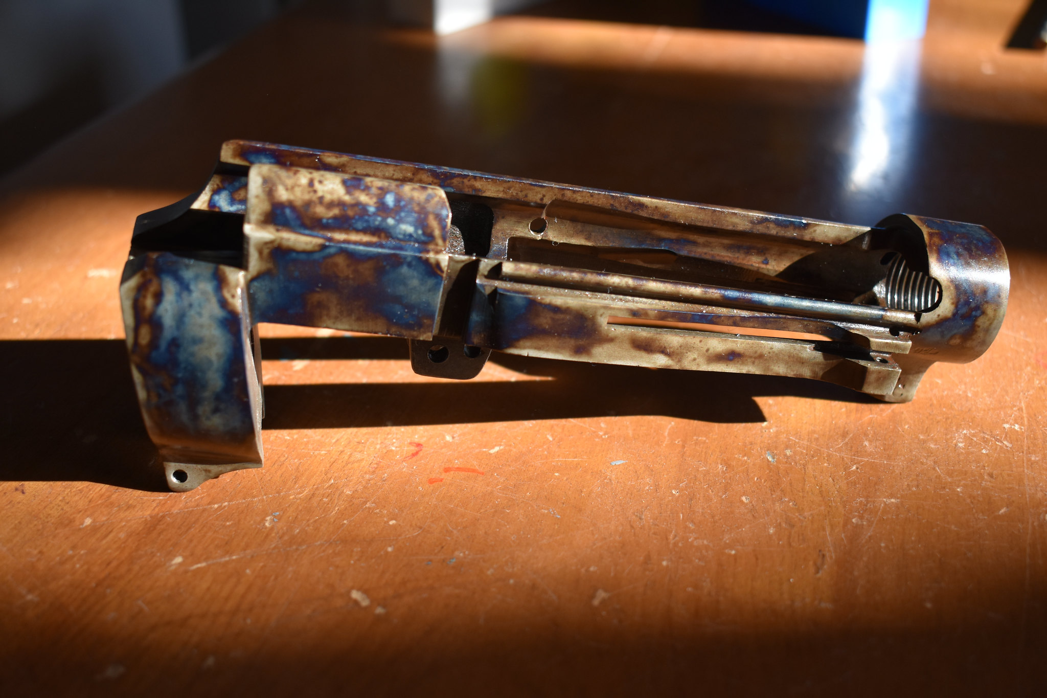

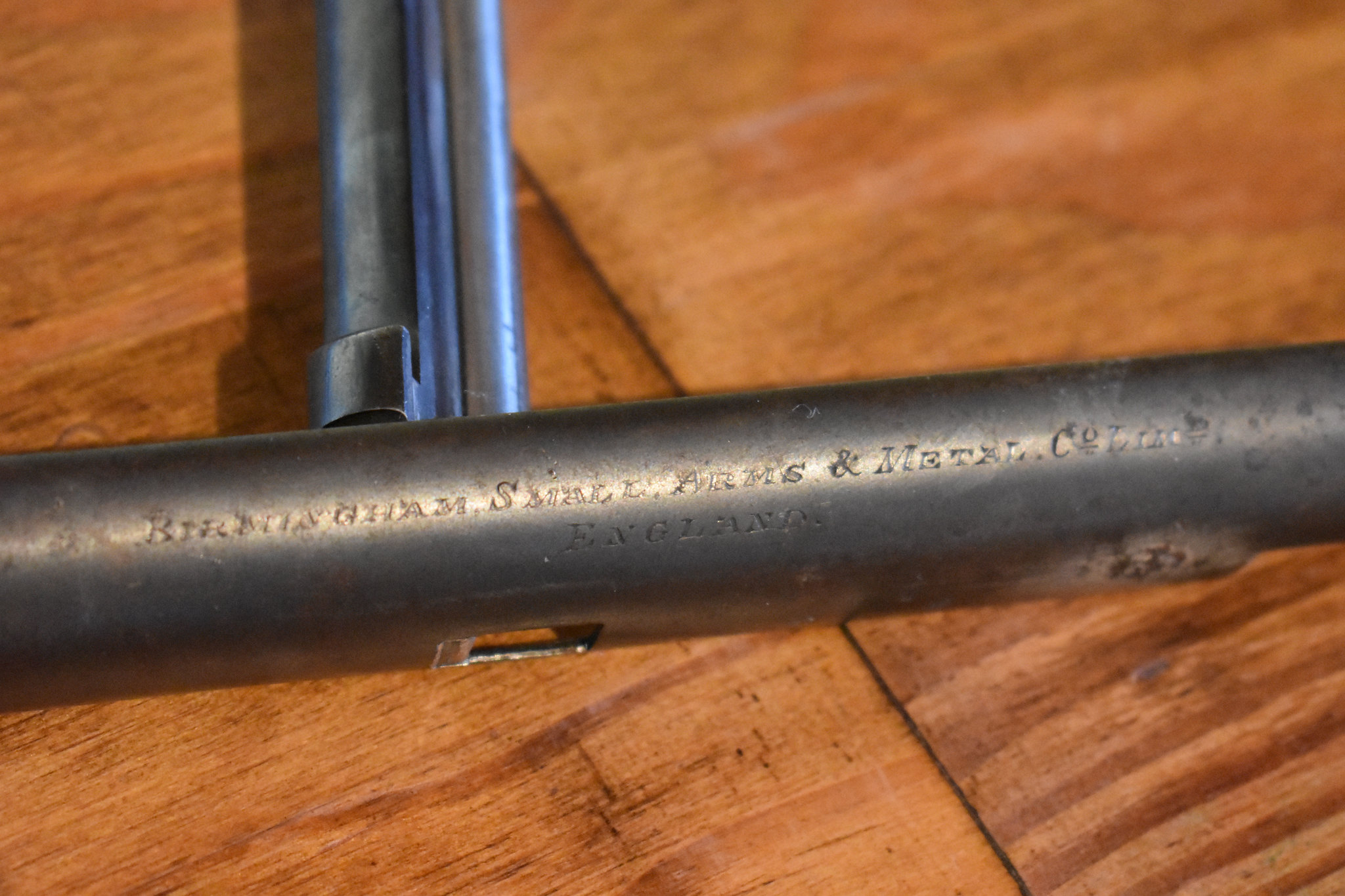

Finding my self with a stripped LEC action i got in a trade, it had all the stamps crudely scrubbed off. I wasnt sure what to do with it, i do love the cleanliness of the no charge bridge or cutout for it and no safety. i decided to make a lee speed type rifle with a tang safety.
i used a diamond hone to flatten out the action. i wanted to chamber it in a Mid bore, i went with 6.5x53R as i have a barrel here chambered in that as well as 50 cases made with reformed 303 brass. made a barrel nut to attach the barrel to the receiver. (nut screws in tight to the outer receiver ring then the barrel threads up against the inner receiver ring, so both bottom out and tighten into place)
the bolt is a MLE that i converted to an old lee metford style, dust cover but no safety on it. i still plan to sweep the bolt handle ahead and flatten it out like the LEC bolt seen in the pic. i even went as far as to find a old style lee metford cocking piece that doesn't have the cutout for the safety latch. i also have a nice BSA commercial dust cover to use on the rifle (rifle is clearly is Enfield made being a LEC but that dust cover will look good high polished blued)

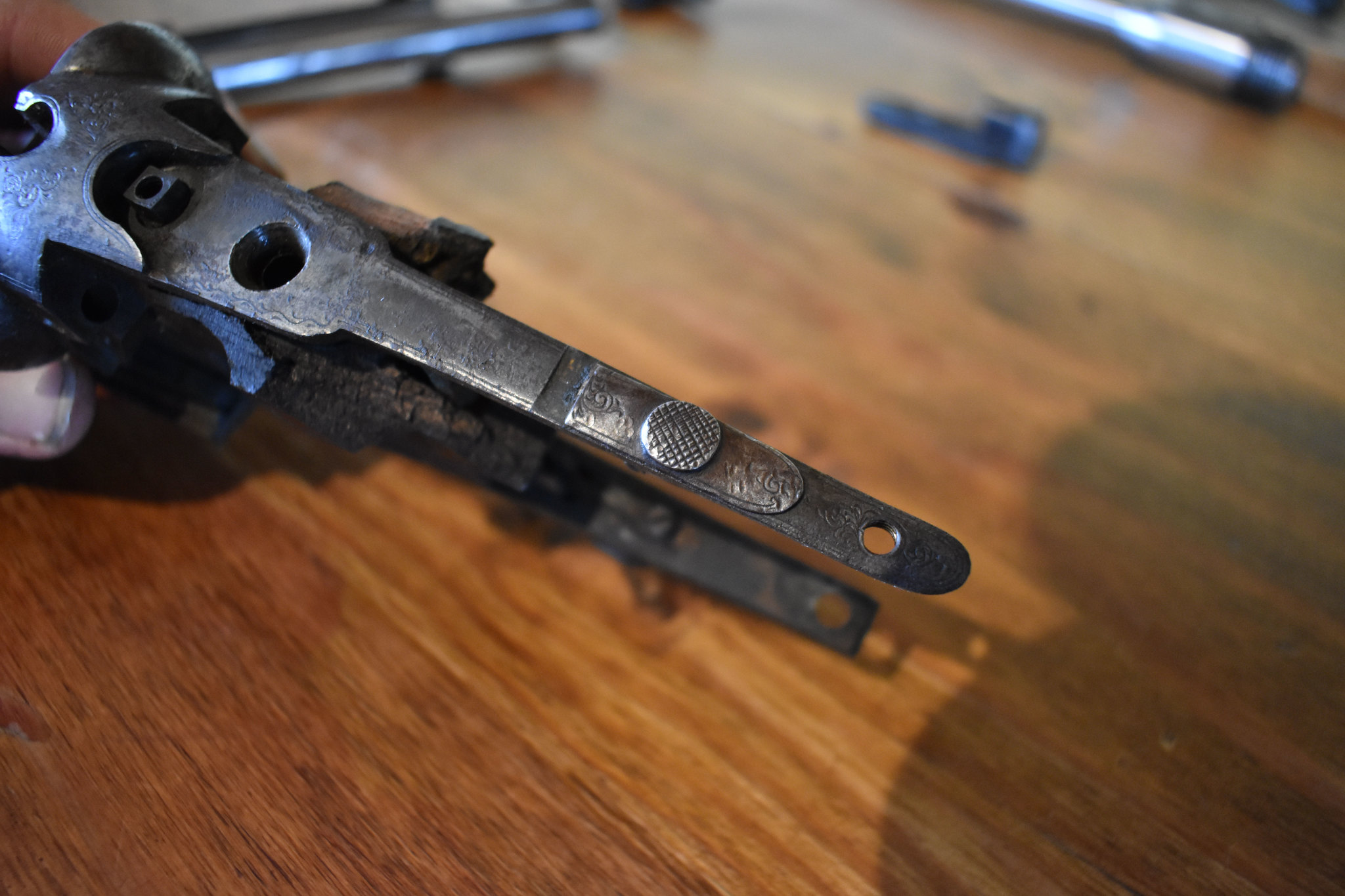

the tang safety will be made out of an old shotgun safety. it should be pretty straight forward doing it the same was as the lee speed tang safety works.

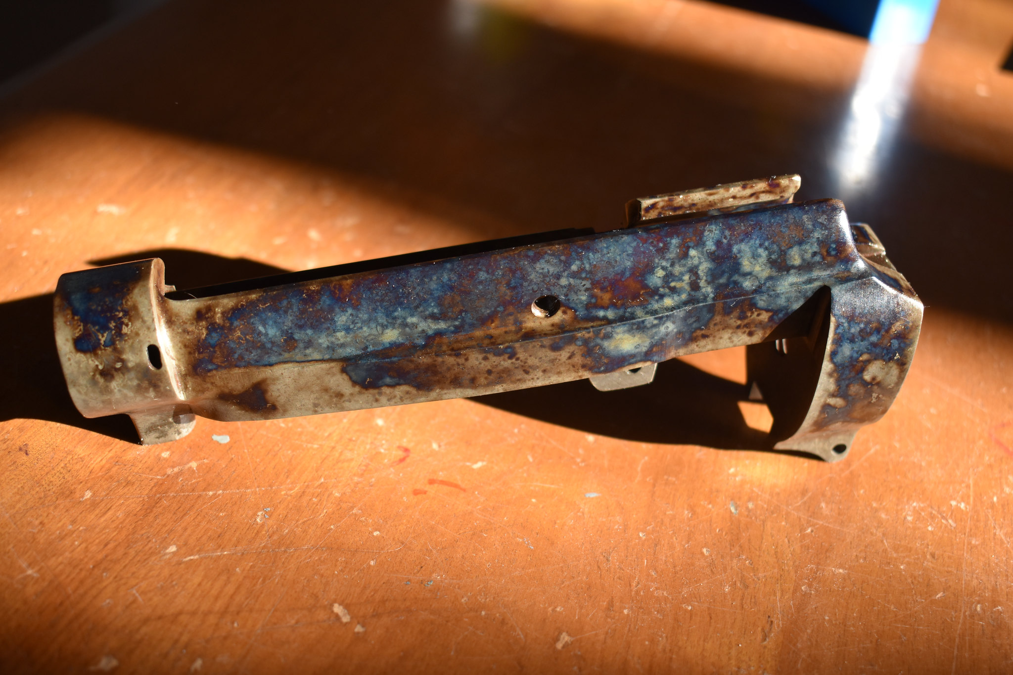

ive been trading some machining work back and forth with a local guy who does color case hardening so i had the LEC receiver one day i was meeting and i decided to get it CCH. i think it turned out really well. im pretty excited about it.
i still need the other parts of the rifle done with a high gloss blue. not sure what im doing with the bolt. i may just polish it, it will be mostly covered by the dust cover anyway. i also need to have a stock made for it still.
i have an idea of what i want it to look like. im not sure how to get there though, it will be a work in progress
open to opinions and thoughs

I have seen one of those tang safety assemblies disassembled, and making one is certainly a practical option. A little rectangular window needs to be cut through the butt socket for the finger that blocks the sear when the safety is pushed forward.

Should you want, I can dis-assemble a commercial Army & Navy Lee Speed which has the B.S.A.Co. patent tang safety & take some photos for you of the holes Tiriaq spoke of, as well as the other required cuts to, and holes in, the receiver & the required inletting to the butt-stock.

Thanks guys, im pretty excited about it. Ive been back abd forth in building one for a while then i decided to do it after a few years of wanting too.
I only got it CCH on a whim. I glad i did. I think it will be pretty easy to work with and keep tasteful.

I have thee patten pics for the safety, also another member has show me pics and made a few drawings for me.

Hot water method? Rust bluing? I was thinking that. I have done hot costic bluing before but that was a bit black and flat in color.

Hot water method... Boil, swab, boil, card, boil, swap, boil, card, etc. Doesn't use a cabinet.
A well polished caustic blue job can be very attractive, but I don't think it would be appropriate for a classic like this.

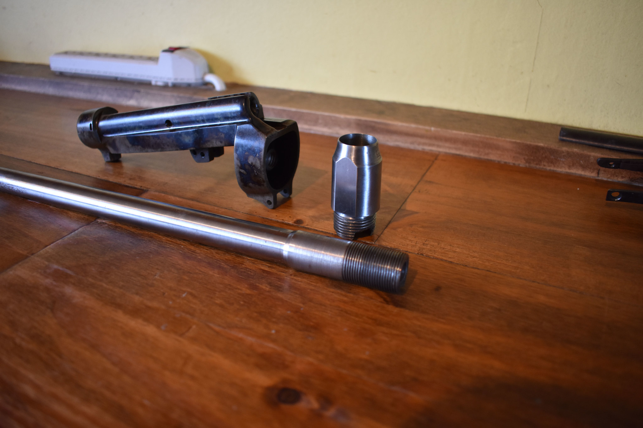

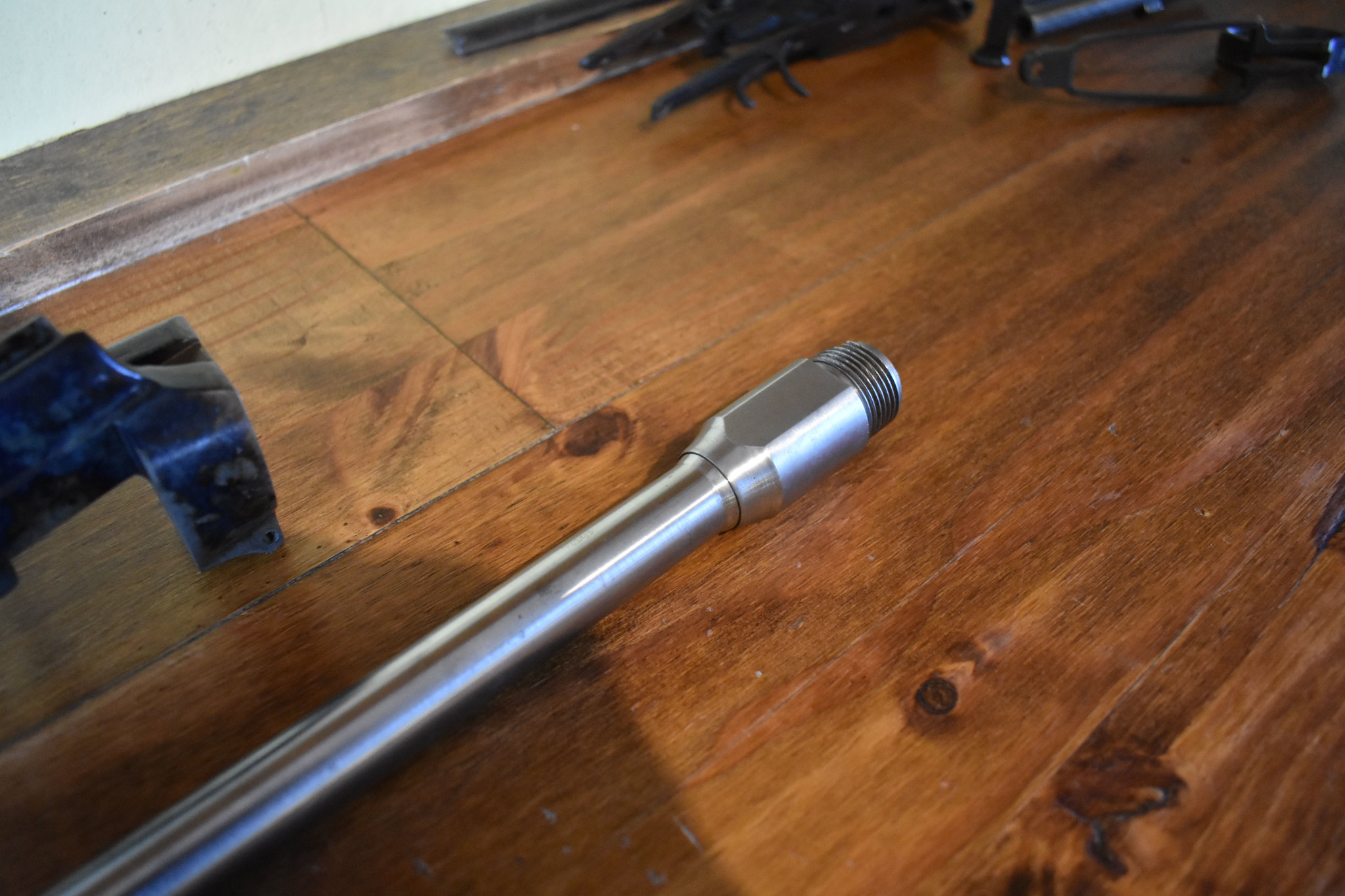

Excellent project Evanguy. This is definitely my kind of build! Any chance you could post some more pics of your barrel and adapter system, especially from the breech end? Very interested in this. We've had another thread going discussing this very issue.
Thanks for the kind words guys.
I do plan on using one of those rear sights on my rifle as well. Or i may use a NEC 3 leaf rear if i cant find a lee speed one
Yes very subtle things make up the rifle. Its hard to believe they are the same basic rifle as a 150$ sporter LE.
I can post more pics of it. But it is very straight forward For rimmed cases. The od if the sleeve is threaded for the receiver. And tightens up on the outer receiver ring. So that can be install and torqued. Then the barrel just threads into that as any barrel would but it gets tightened upto the inner receiver ring. Then i mark the extractor area unscrew it all and cut it out .
Some times a silver solder the nut to the barrel after i have it set if its a non rim case and i need to set head space. Like on my 6.5x55 no5 LE build. Then i can still change the bolt face to dial it in.
I have used this method in probably 15 different builds using LE actions. I have some threads on projects that i did the same process on.

If I'm reading this correctly (I may be a bit fuzzy on the "tightened up to the inner receiver ring" part - I think we might just have different terminologies for the same things), you're pretty much using exactly the same method as I have, but mine tighten up to a step machined on the barrel O.D. If you get a chance, a couple of pics might help overcome my cognitive limitations. Very impressive work, sir! I, too, have just signed up for your fan club.
Like a Mauser 98, there is an internal collar in the receiver ring. The face of the barrel is set up hard against the front face of this collar. Like a Mauser, a Lee Enfield barrel can be machined to torque against the internal collar, the face of the receiver ring, or both.
In this rifle, the breech sleeve is torqued against the face of the receiver ring, while the barrel is torqued against the internal collar.
Another way, as you have done, is to torque the sleeve against the receiver ring, and the barrel against the front face of the sleeve.
Ah, that explains it. I've never worked on a Mauser (not because I don't like them, just haven't had a reason to do so), so I'm not acquainted with the internal collar. Thanks tiriaq.
Tiriaq did a better job then me explaining it.
Ill get pics if the inner and outer receiver rings. And pics if the barrel and sleeve and how they all fit together tonight.
