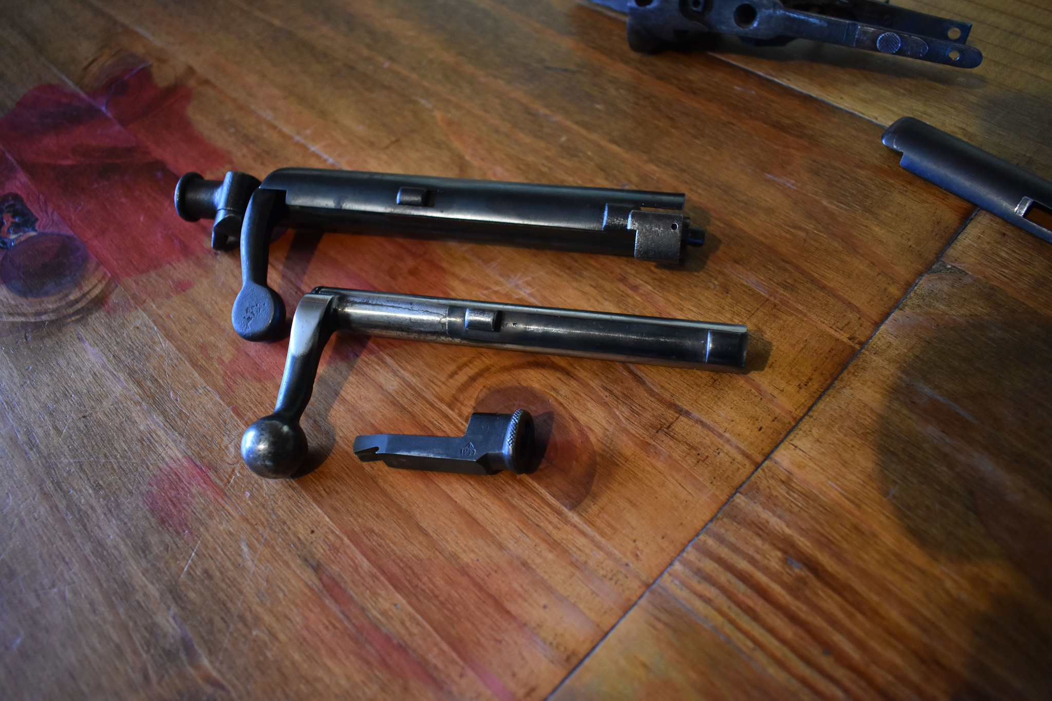

No its not really to late. Im even going to turn the knob a bit upwards to get a better handle on it. So ill have to repolish it anyway
Whats your reasoning for not having it moved ahead like the factory LEC bolt?
I like the top bolt handle more then the bottom

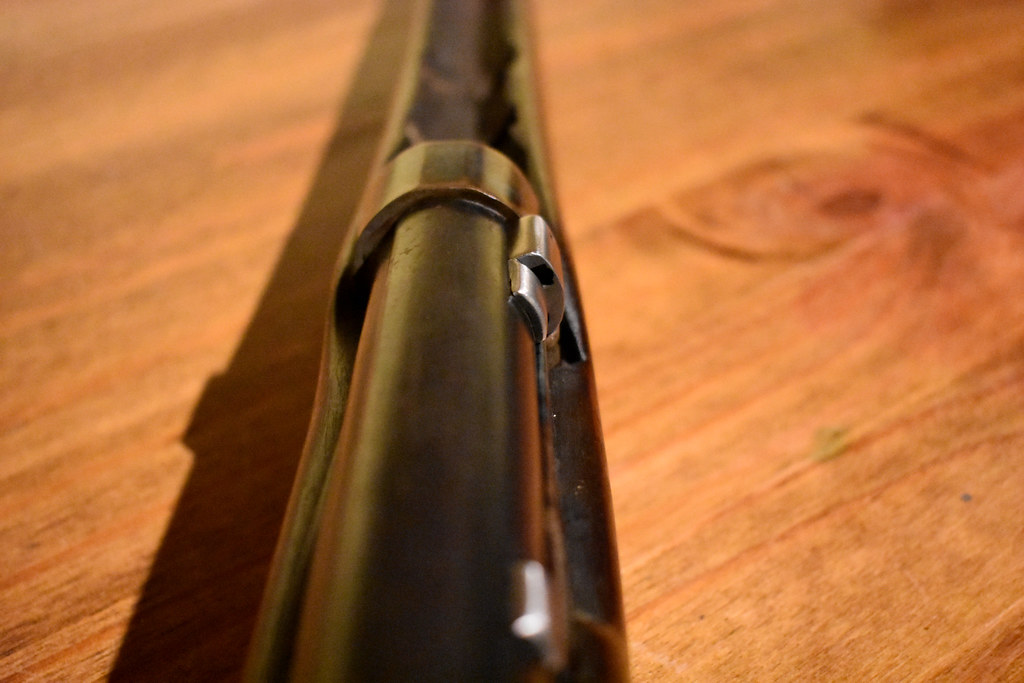

I wonder if a reproduction of the classic standing leaf, plus flip ups, plus ladder rear sight could be fabricated by using a NECG express sight insert, plus a MLE leaf in a new made base? This might be the only reasonable alternative to finding an original rear sight. The NECG express sight, without the added ladder, wouldn't be inappropriate, all by itself.

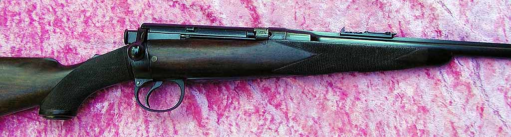

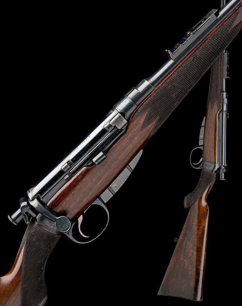

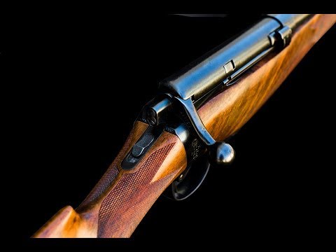

also these are the pics of where im getting my inspiration for this build. none of these are my rifles but seeing these pics made me want to build one to that level of awesomeness. its a combo of the 3 lol
i like the bluing color and shine of the first pic
i like the lines of the wood and rife it self also that shine in the second pic
and the third one just oozes awesomeness, full rib, tang safety. its a real beauty
What is this Enfield picture on top that looks like a straight pull?! And tang safety?!
Oh, dust cover. Not familiar with those, the tang safety looks like some nice work!

Tiriaq, i agree it should have the ladder sight as well as the express leaf sights , they could work by them selves as the 375 lee speed uses only leaves no ladder but i do like the look of the assembly, thanks for the idea, that's actually a really good one.

cody c, that top rilfe is a home built job. yup it has a dust cover covering the action, its a look i really like in this rifles. no charge bridge, no thumb cutout, no safety cut/volley sight out and a dust cover makes for a super clean action
fingers284, yeah i do like the p14/m17 actions a lot. they seems very robust and strong. quite over build, my 500 jeffery will be about 9 pounds with a 20" barrel, iron sights, rocking a crude sporterizeed millsurplus (just like every 200$ p14) stock on my p14 action. the bolt handle will stay as it is and the ears are gone. it now looks like a Remington model 30 express.

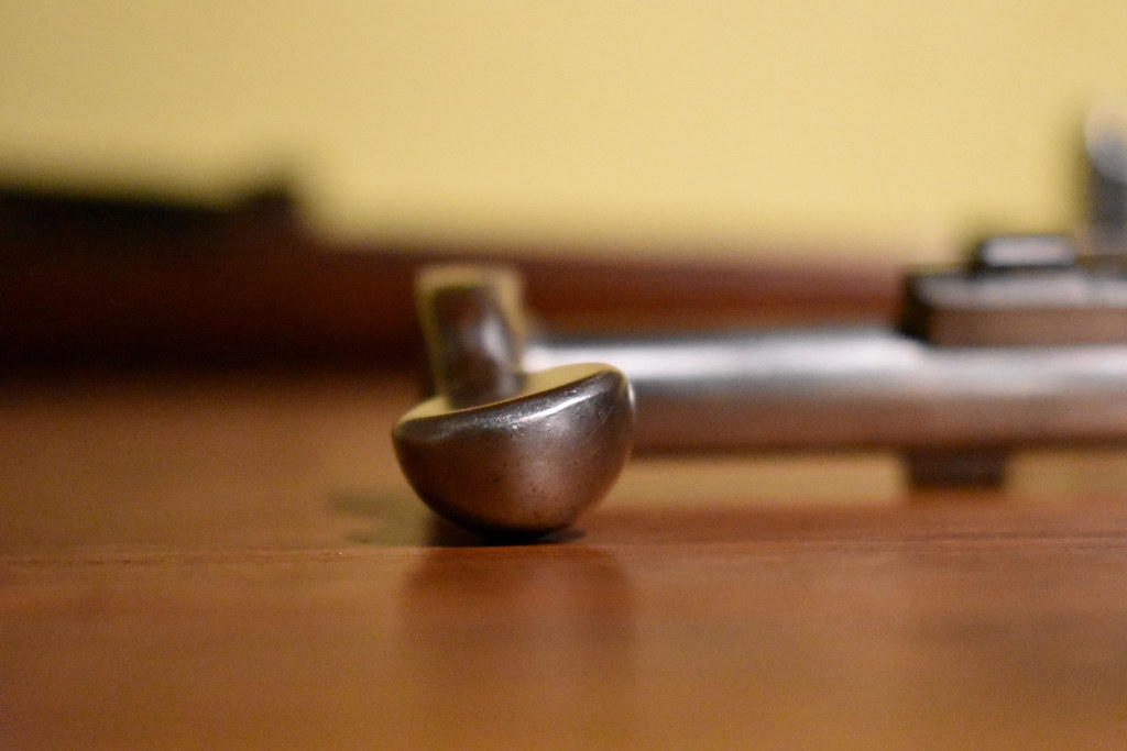

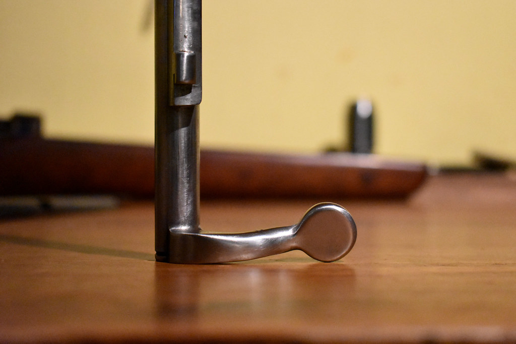

my bolt right now ive swept it back a bit, its still ahead of the factory location but not as far ahead as any of the pics, and i turned the ball out a bit, its not more like a knife handle, almost straight down with the bottom kicked out.

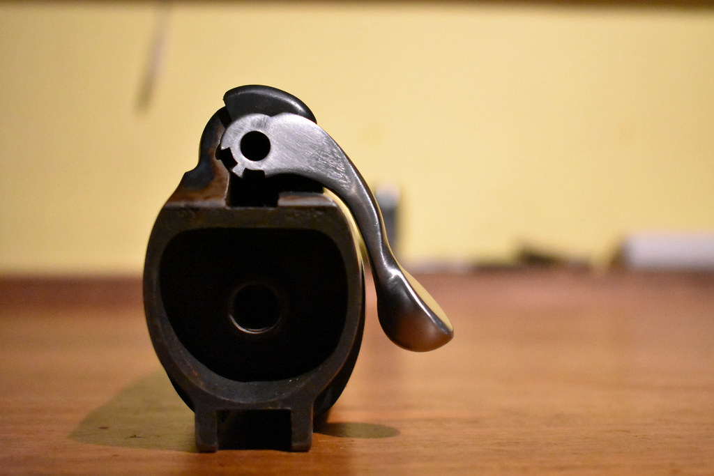

i did some more work on the bolt, i spent way to many hours on it trying different ways lol, the more i held it while polishing it each time the more i got a feel for it and wanted to change its shape again. i like it now. the handle is only swept ahead to make the end of the ball lined up with the back of the bolt, the bottom is flicked out a bit, the flat is also twisted back a little, and there is lots of bolt handle to receiver clearance.

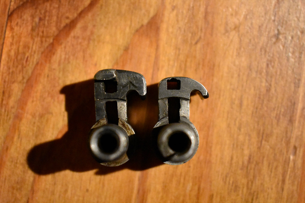

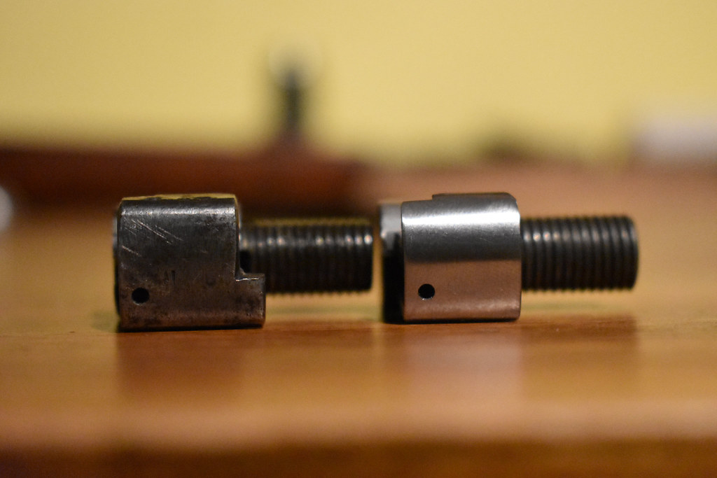

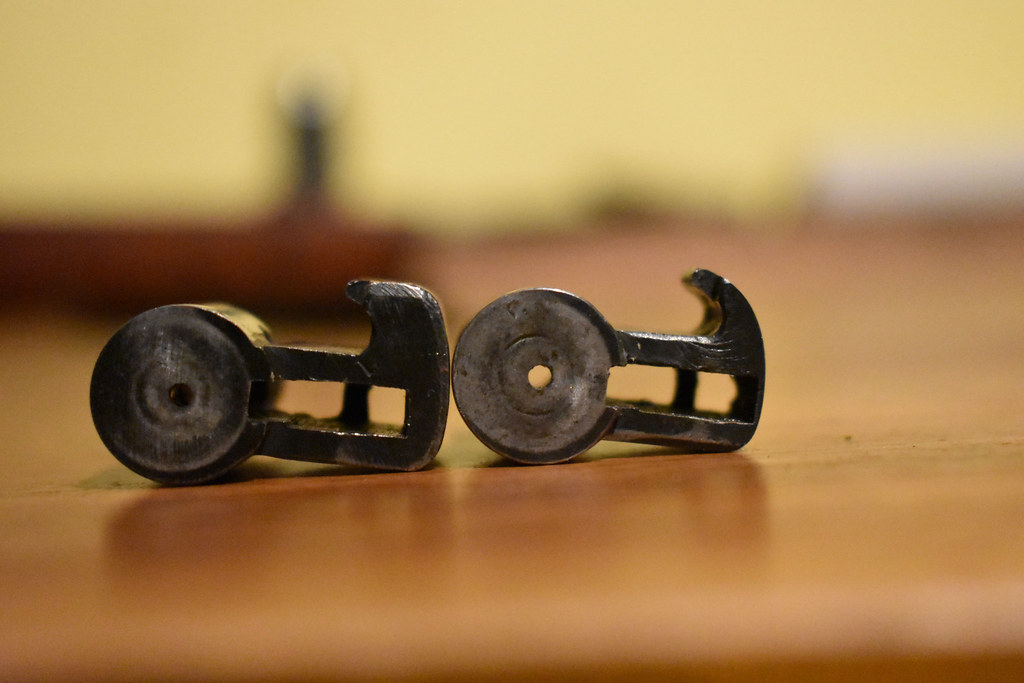

i also reshaped and streamlined a bolt head a little for this rifle, its noticeably smaller and doesnt stick out so much like the factory one.

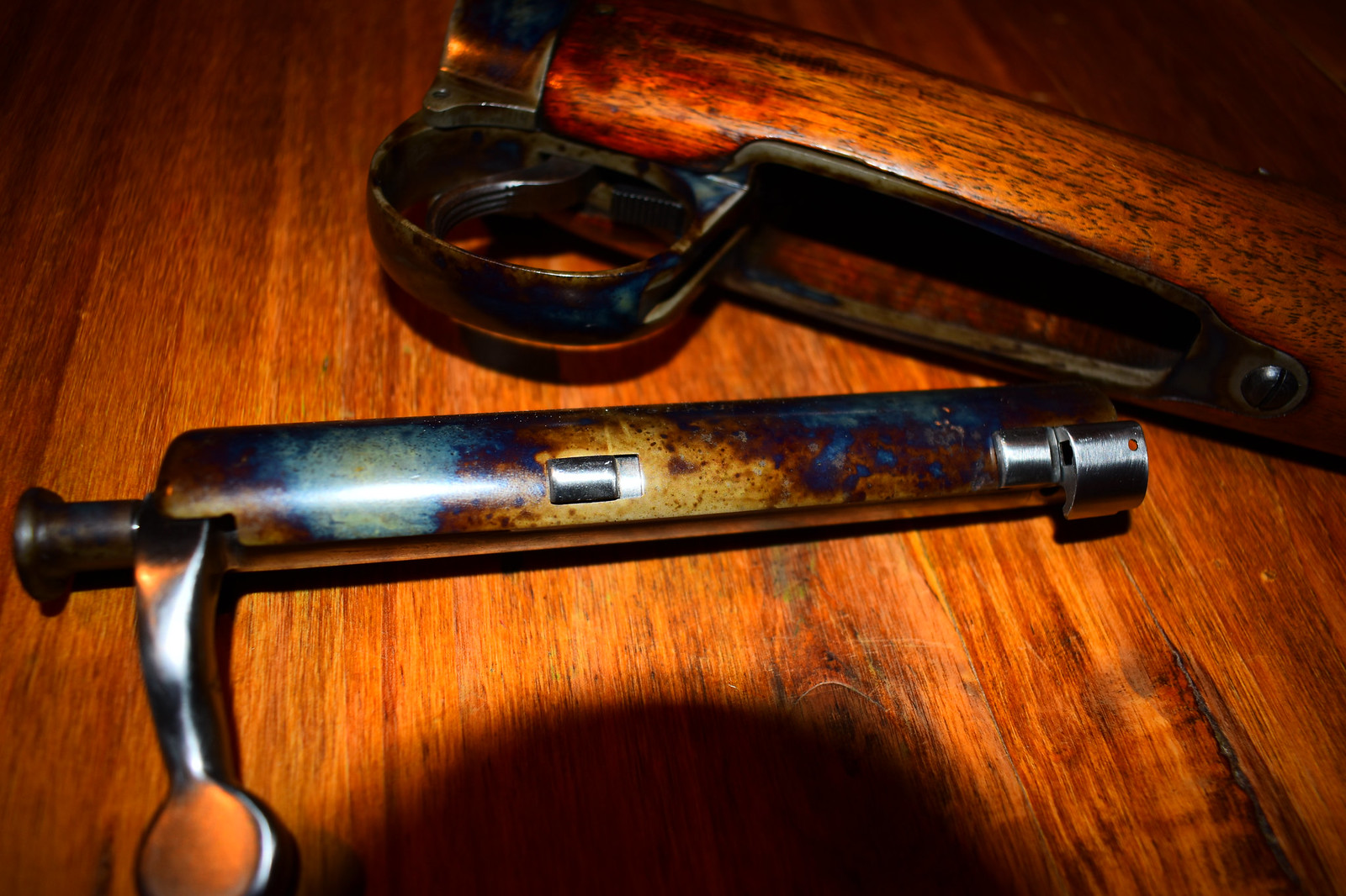

so the bolt is done now, im just waiting on the cocking piece and dust cover to be done cch to be able to put it back together.
The bolt handle is very "eye appealing" now and Im sure it meets your approval...however if I may have an opinion of the "done" result. "Sporting Rifle" would indicate to me that the rifle is intended to be used in the field, not just a bench rifle. The first thing i noticed is that the knob is super smooth now and the flat spot is sloped back, both would limit the gription of the thumb for bolt retraction and closing, especially with "#### on closing" of the Lee's. the second thing is how tight the bolt head is tucked into and close to the action. Hunting seasons in Canada are mostly cold weather, gloves required operations and I think the tucked in bolt head will be "missable" with gloves in a hurried situation as hunting often is.
Don't take this as anything more than an observation on my part .

Still left to do is i have to get sights for the barrel, get the barrel and sleeve blued. Have a stock made for it and machine for the tang safety. The receiver is pretty much done now.
Also yes the bolt handle is smooth. Id have someone check it or engrave it if i knew who could do it. I dont plan on attempting that my self, as im sure it involves artistic skill.
The tipped back bolt handle works as a wedge in my hands when closing the bolt. Its also close on cocking too. So i have excellent grip with bare hands on it that way. Dealing with a stuck case may be problematic as i dont have near the grip when pulling the bolt back
Also i do plan on using this rifle in the field for sure. But i have not really thought about using it in the winter. I was picturing a summer rifles this whole time. So i never even considered it whilst wearing gloves. Gloves will suck. Unless i treat it like a single shot and dont count on a fast second shot
