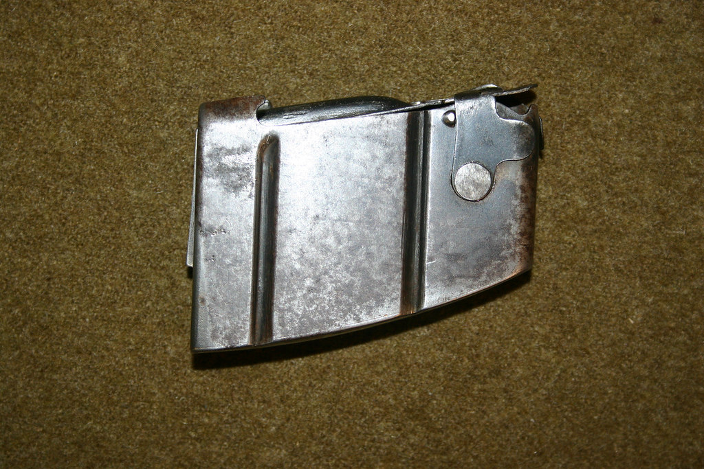

I did just buy this mag for the rifle today. I have a reproduction fish belly mag as seen post 93. But I had the chance to grab a real one so I did. I'll save the repro for another build or use it in my Parker hale custom no1

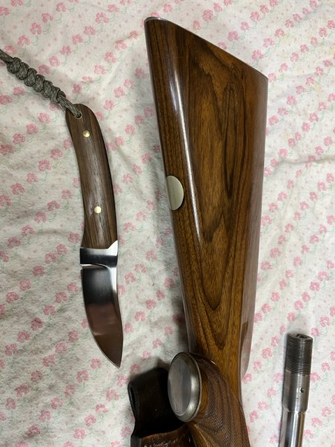

still lots to do but the stock is now finished and i had a knife made of the same wood the stock is made of to have a matching knife.
if i had to guess what's left to do is, engraving, soldering the rib on the barrel, bluing the barrel and barrel nut, installing the rear sight
there may be more but its getting close either way. ill update with pics when the rifle gets here.

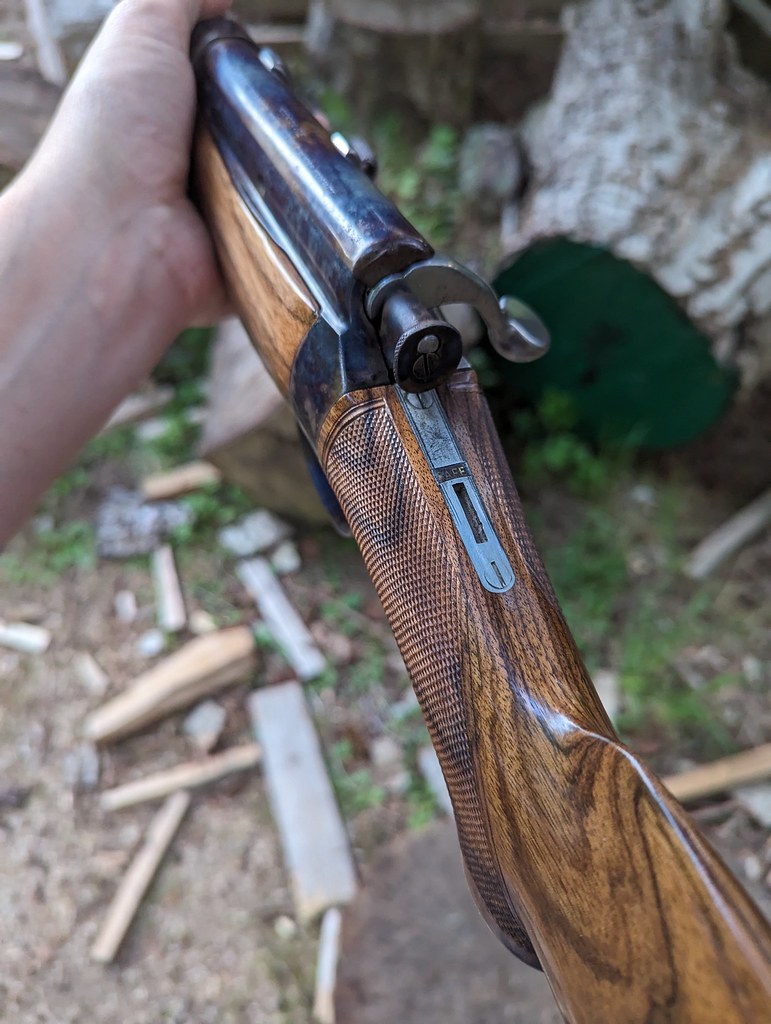

i got a few pics of the stock, ill post better ones when it arrives. the knife and sheath look awesome, same chunk of wood the stock is made out of
Chris and Wayne have done an amazing job on this stock

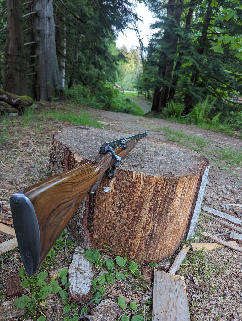

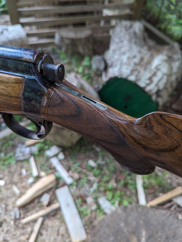

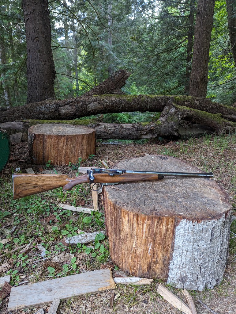

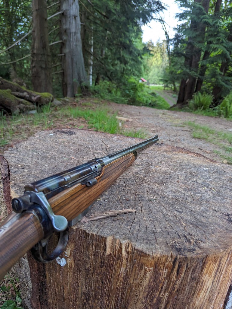

So i have the rifle back in my possession. I'm so excited about this build still its going very well even after 3.5 years, the rifle just keeps getting better and better. I'm very pleased with how the rifle stock turned out, it couldn't be better.
Chris and Wayne have done an amazing job between supplying the stock blank, roughing it out, fitting it it and finishing it, modifying/installing the butt plate, installing the grip cap and fore end cap, fitting and installing the safety tang. the checkering is perfect. very fine and fitment is so appealing to the eye

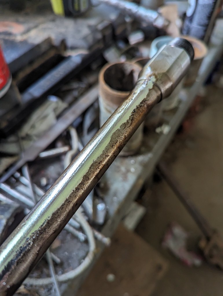

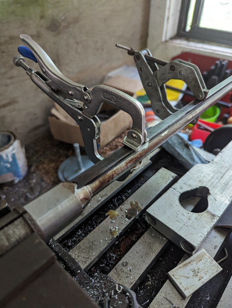

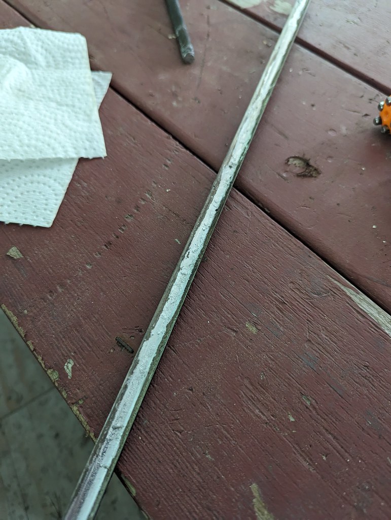

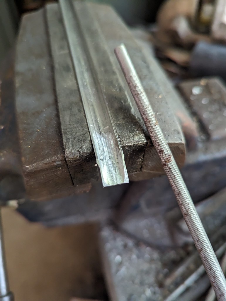

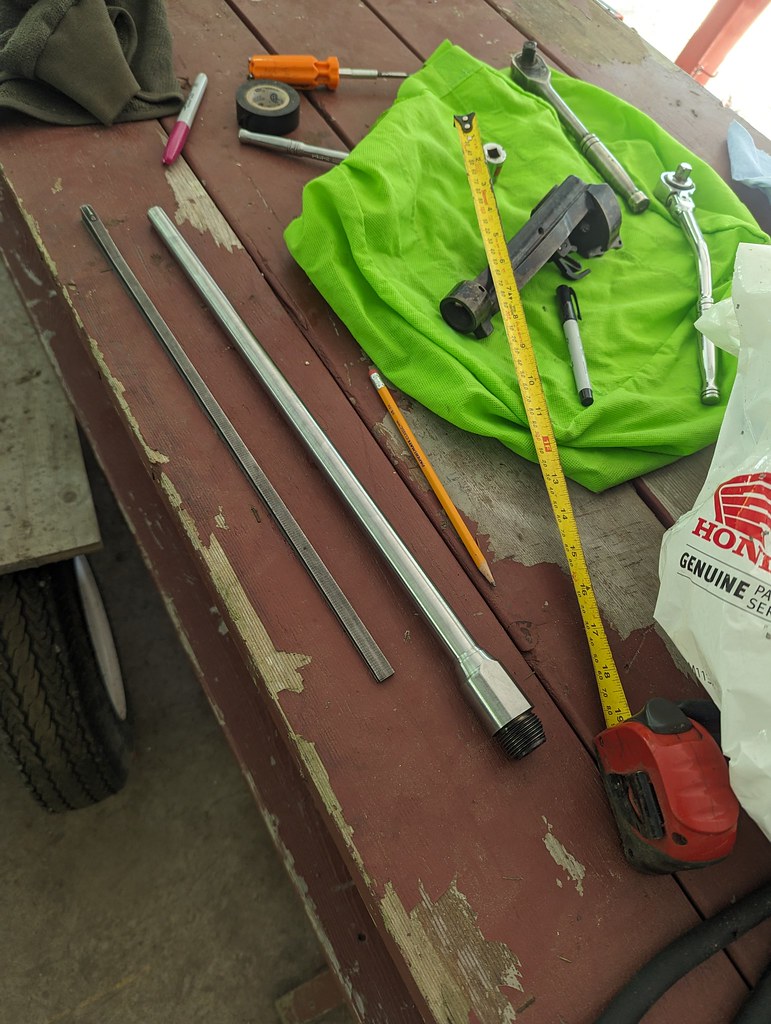

since picking the rifle up yesterday, I've soldered the barrel nut to the barrel it self, fitted the extractor grove and installed the rib
the rib and barrel were tinned before installing. it went very well.
i still need to cut the large dovetail for the rear sight base. I'm going to install the ladder and leaf sight into a base then install that into the rib.
the rifle weights 7.5 pounds with the rear sight setup on the scale.
I plan to add a half band on the barrel for for the front sling mount and a sling swivel on the butt stock.
The over all length of the rifle is 39" the barrel length is 19.25" and the length of pull is 14"
The rifle feels and handles so well, its almost all just finish work left. some engraving and blueing really is about it after the sling swivels

Ardent, I love the straight comb as well, its one of my favorite feature on the stock.
