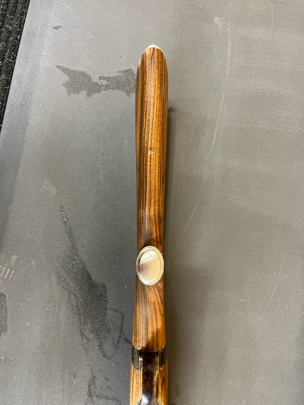

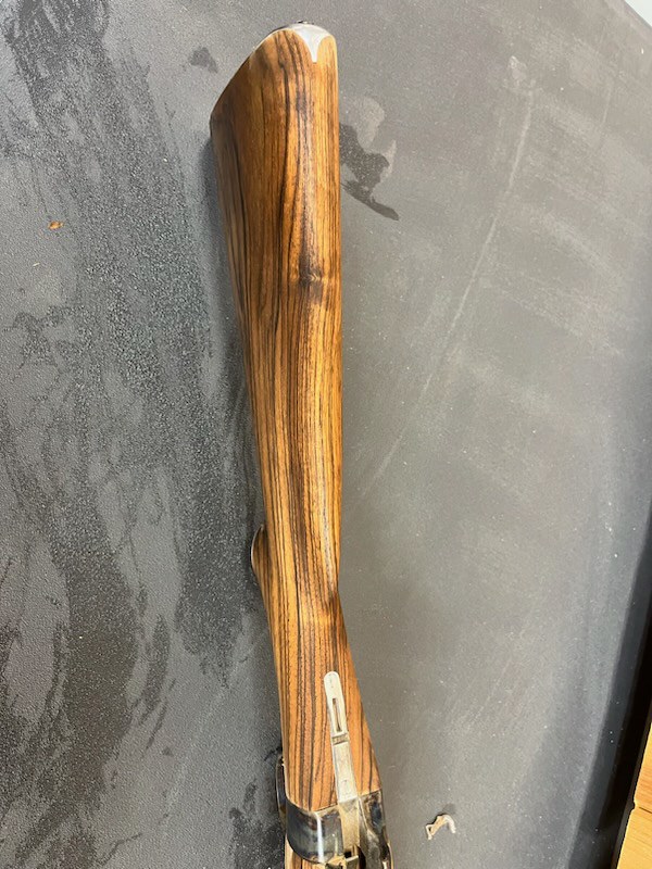

I got a few more pick from the guy finishing my stock, Wayne.
he has a few things left to do, like the checkering, stock oval inlay and the finish.
then once I get it back I have to fit the tang safety internals, install the barrel rib, rear and front sights, sling swivel on a barrel band and one in the butt stock
send the barrel nut, grip cap, butt plate and mag for engraving, send the barrel and mag for rust bluing and the barrel nut, tang safety, butt plate and grip cap for CCH
then, maybe then it will be pretty much done.
the pics were texted to me so not very high resolution
the stock was wiped with water to show the grain.
DGY, hollowpoint, mctrigger and Decker9, well you guys summed up my thoughts perfectly on this build. I'm very please and even a little surprised how good it looks. I cant wait to see it finished.
Thanks, funny you should mention that, the straight comb and the grip cap being parallel to the barrel are my favorite visual features on the stock.
Well the tang safety looks pretty fancy too.

I got the silver today. I'm going to use a 1910 Canada 50 cent piece to cut up and shape to make the stock oval. It's 90% silver.
So I need to shape it, polish it and get it shipped to Wayne on Monday to inlet it into the stock. He's waiting on this stock oval to finish it.
