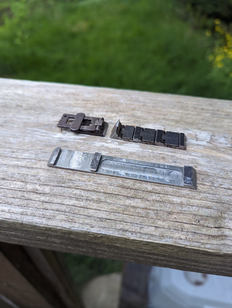

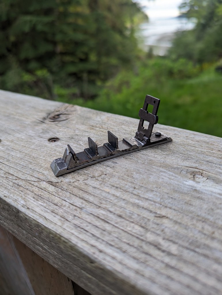

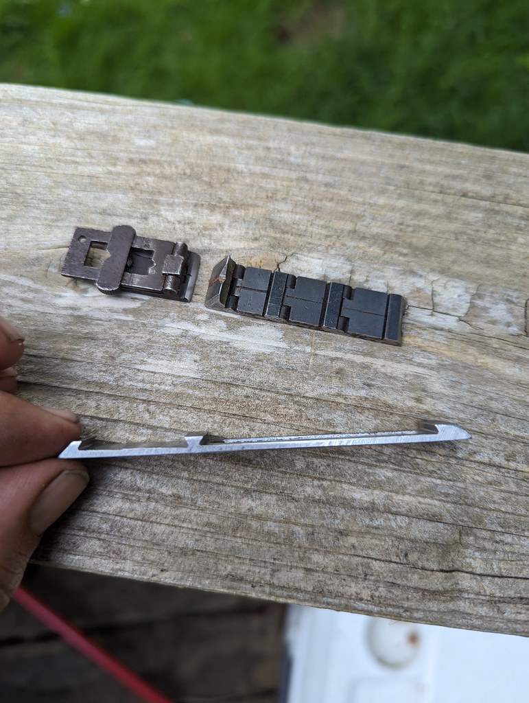

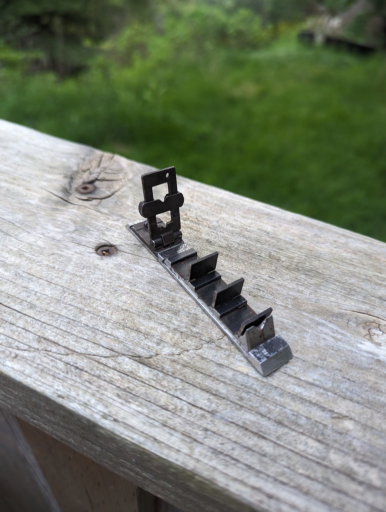

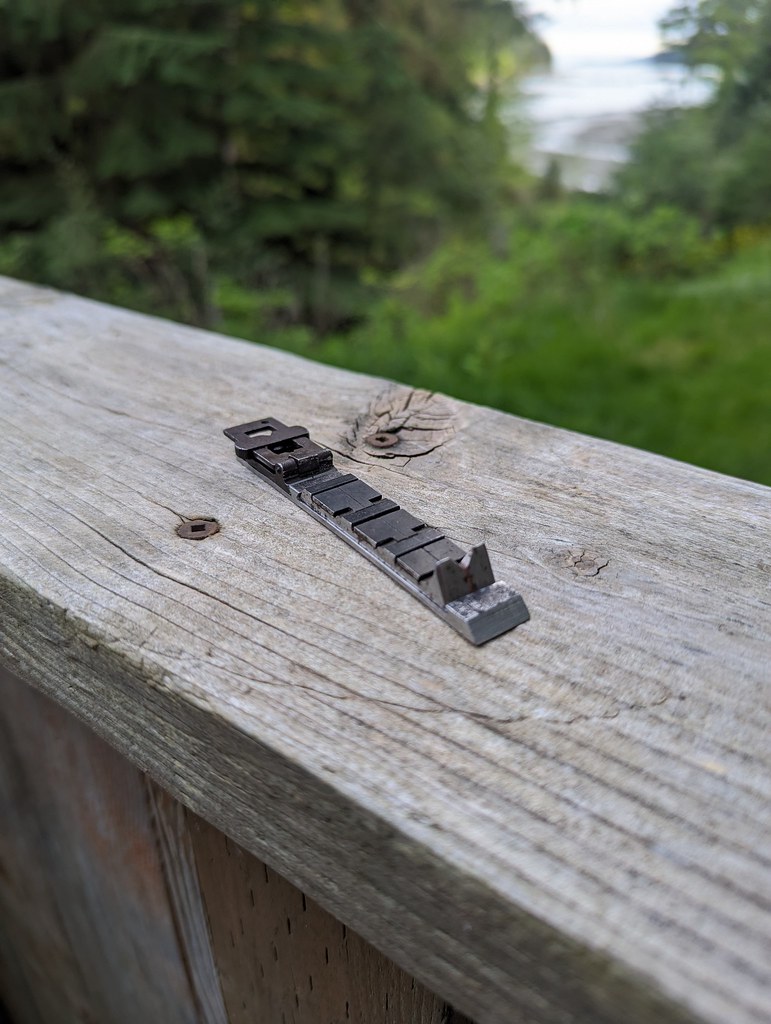

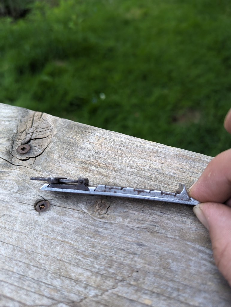

i did some work on the rear sight. i made a base for it and hand filed the dove tails in it to make sure there is a tight fit. (60*, used a 5/16" triangle file one side(bottom) ground smooth)
i still need to cut the dove tail in the rib to install the base.
Yeah I can see what you are saying it is a bit much and ill never use the ladder im sure, if I was building a modern sporting rifle I would definitely use just the exxpress sight without the ladder, but the rarest most valuable lee speeds had 2-4 folding leafs with the ladder/sliding sight. Actually that ladder sight is from an original lee speed rear sight that someone had buggered long ago.

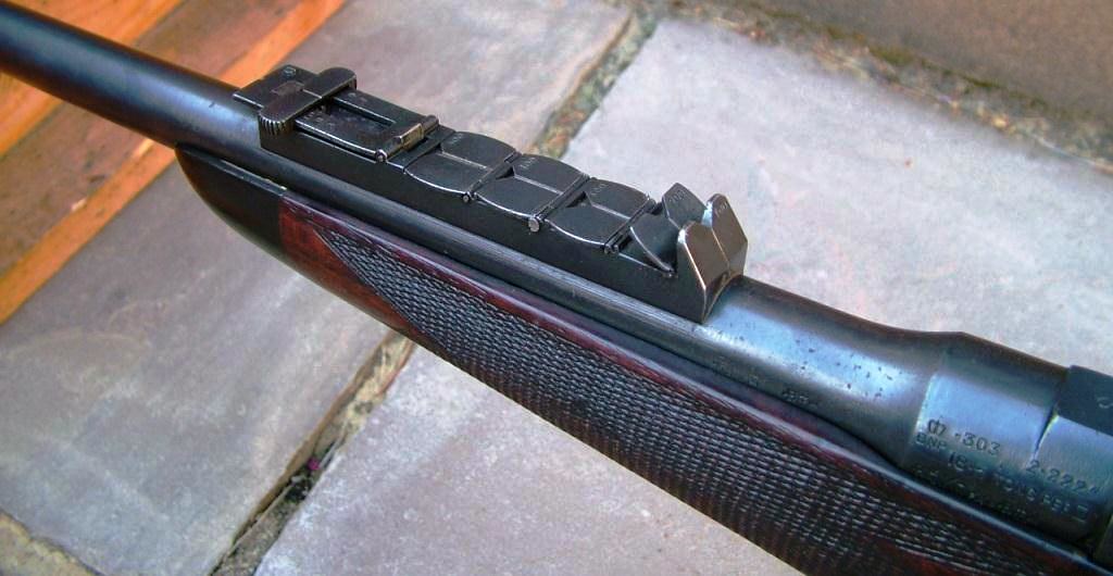

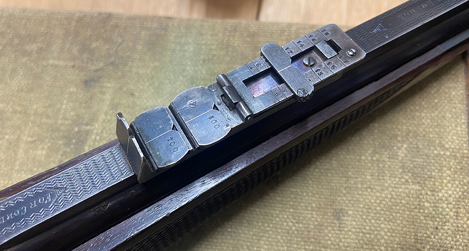

here is a pic of an original rear sight that i would love to get my hands on, but the are very expensive and hard to find, and id also have to mill it up to be able to fit in into my rib, so i wouldn't want to ruin an original
the second pic shows the best sight i could get for this rifle i have never seen one for sale.
I do not have a centerfire rifle with sights like shown - I just got a 7x57 BSA "sporter" rifle with a barrel mounted rear sight standing leaf marked "100", and then two folding leaves - one marked "200" and one marked "300". Back in the day, with the old Cooey .22 in the pasture, I did not know about changing sights - it was as it was - "held off" to hit what I intended to hit - aim above the gopher, if it was a long ways away. My Dad used to use phrases like "take a fine bead" - as if there was a way to alter your aiming point by how much front sight bead that you could see in the rear sight notch. What is the shooter going to do if he guesstimates the game is at 250 yards - use the 200 leaf or the 300 leaf - either way, he is probable to want to be able to "hold off" a bit from where he wants to hit. Is not target shooting or shooting for groups or for points - is usually about getting one good kill shot - make it or do not make it.

With respect to the cape sight... Here is the sight on my Army & Navy BSA Model 4 sporting rifle. This was an economy rifle, compared with others posted in this thread. I think this sight was pretty much a standard on these sporting rifles. I've also seen the sight on a .303 double rifle. I suppose there is always the chance that one of these sights might turn up in a gunsmith's shop in the UK. IMG_3216.jpgIMG_3218.jpg
