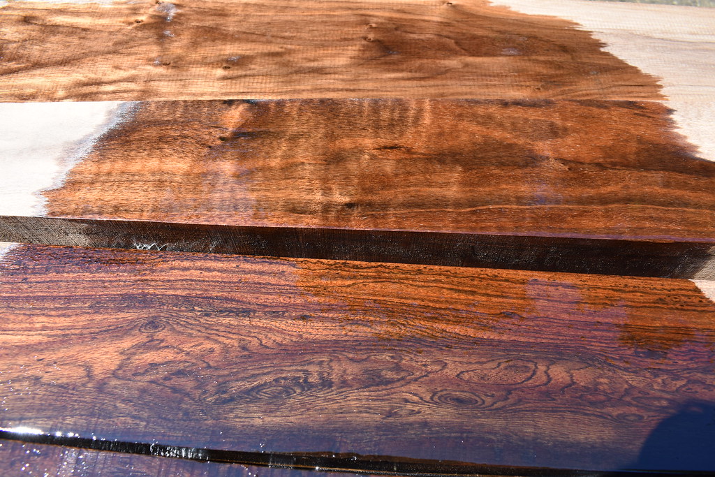

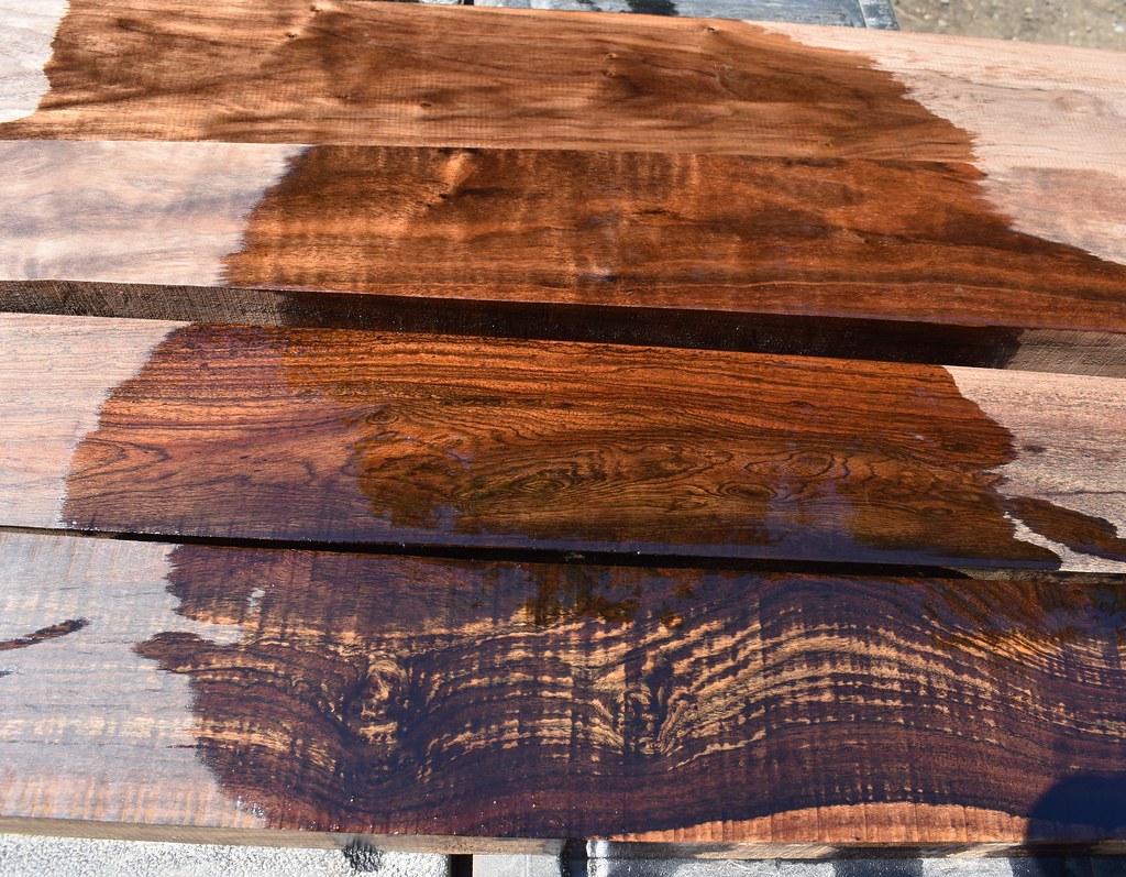

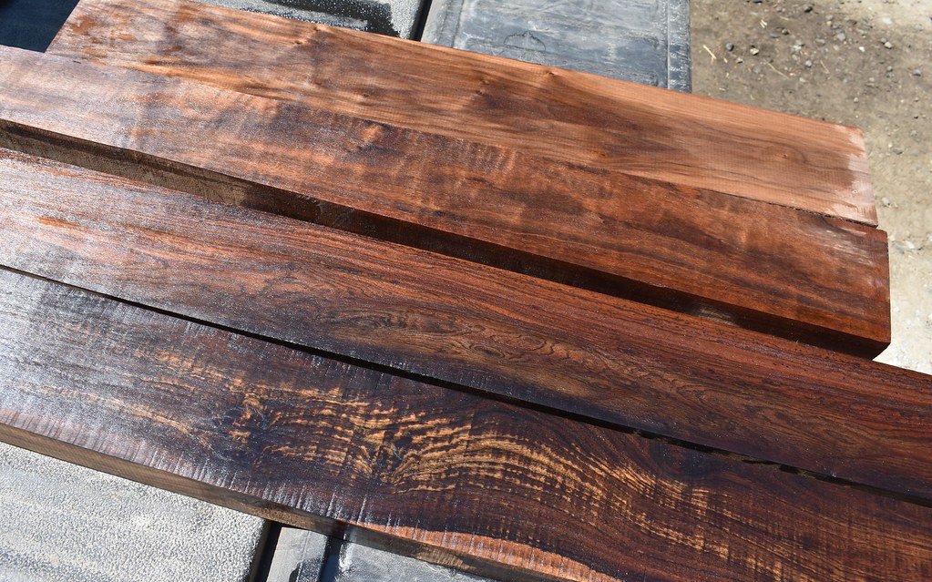

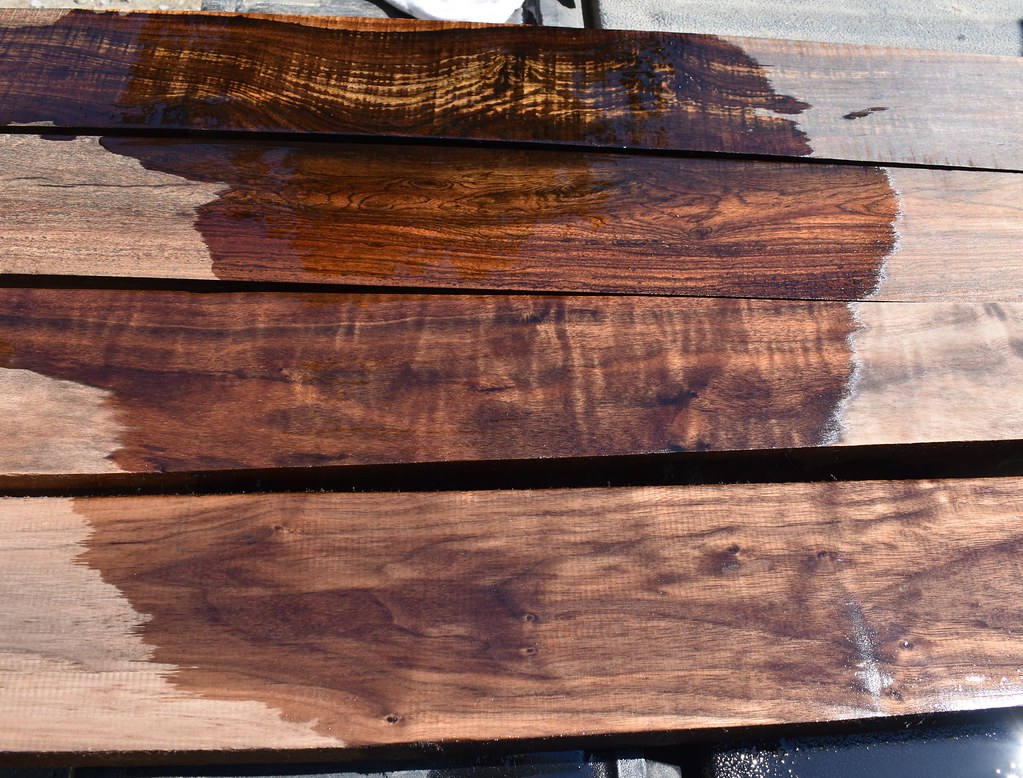

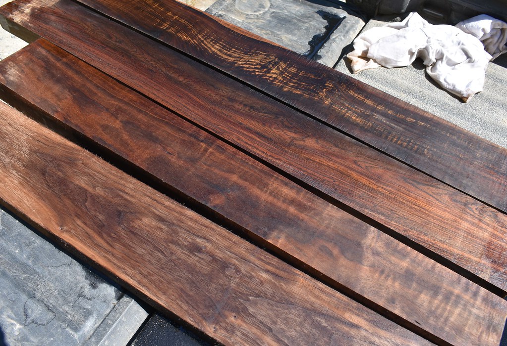

so I have pics of the wood now, crazy how heavy the bocote wood is, one blank of it weighs more then both the walnut blanks. but I plan to build a thin slender stock with it so it shouldn't add to much weight. I really like the look of the claro walnut blank as well and its way lighter in weight.
of the 4 pieces of wood 2 are bocote and 1 is claro walnut and the last is black walnut.
using the fist pic to make this claim, I like the second board from the bottom, that's bocote and the 3 board that's claro walnut, in the last pic the claro is on the bottom and the bocote i like is second from the top (one of the bocote clearly needs to go through a plainer)
what do you all think i should use on this rifle

ya know, the more I look at them the more the claro walnut becomes my favorite. it only cost me 75$ so I couldn't pass on it when I was already paying shipping for my other wood but it cleans up really nicely. and after feeling the weight of the bocote I'm unsure on that. I think it will make the gun feel to oddly heavy for how small it will be. it only has a 19" barrel and I want it to be slender.

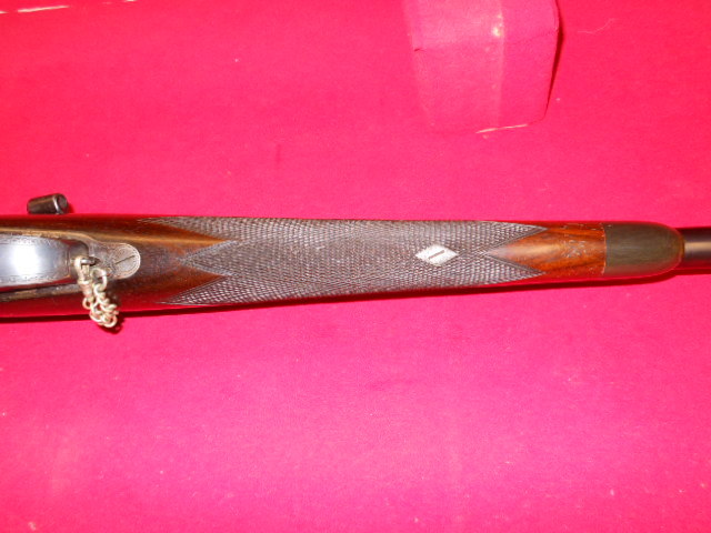

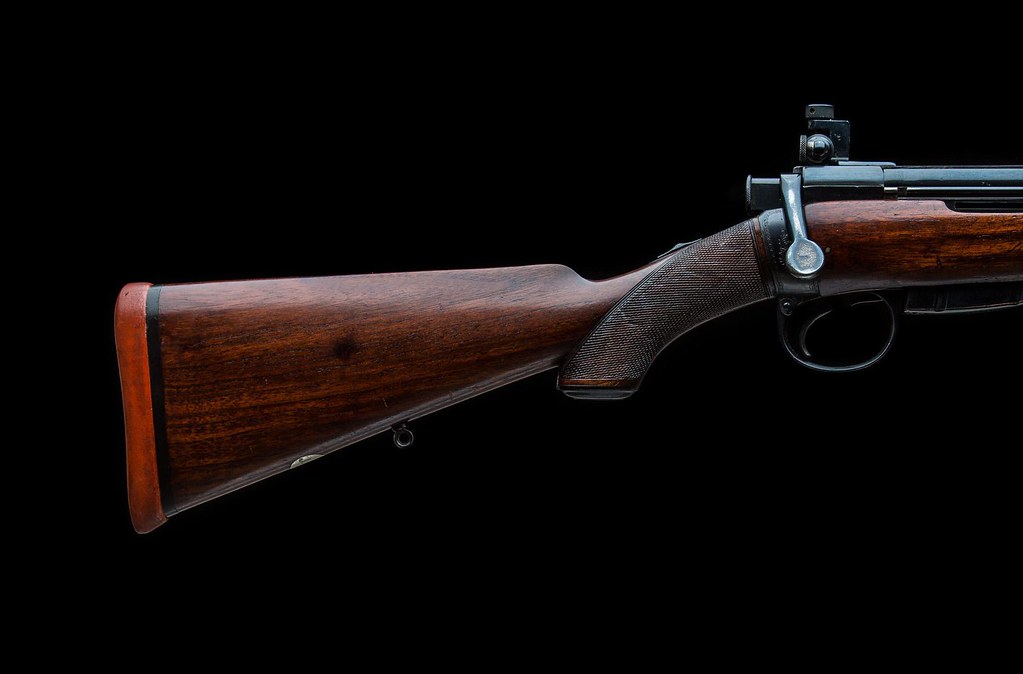

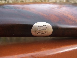

I also need to order some material to make the fore stock tip, grip cap and butt plate, I'm not sure what ill use. I like the idea of tarnished silver, it should only take a few oz's but in its polished state it may be a bit much and maybe ill just use it for some subtle inlays like on some factory lee speeds. I little oval on the butt stock and a small diamond on the bottom of the fore stock. then use horn or ebony for the tip, cap and butt plate

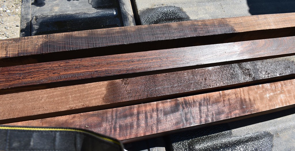

here are pics of the walnut cut into 2 pieces for the rifle stock. I used the rest of the claro walnut to make blanks for my 2x Remington no6's and I also cut 2 pieces from the bocote wood that look the same as the walnut ones pictured.
the wood is a bit more plain then I had wanted it to be and I really wanted this rifle to have nice wood on it but with the cost of the nicest woods and this is my first rifle stock I'm making I figured I should learn on this cheaper wood
