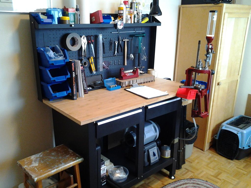

If you can get a workbench while it's on sale from a Home Depot or a Canadian Tire, it will work quite well. The model I got weighted about 80 lbs before being assembled and weighted with tools and things. It has adjustable feet and the top is a 1" thick compressed bamboo plank, very solid and stable. Because it was on sale, I think I paid about $150 for it.
I use the exact same bench. Got it on sale last year. Absolutely love It!
