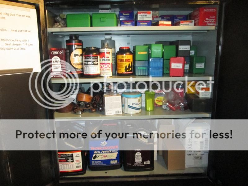

This is what I have. Nothing special in the corner of the garage. Powder and primers stored indoors.

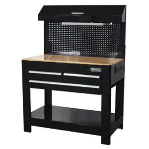

I wouldn't. Notice the other Mastercraft bench that's been recommended has a wooden top that overhangs at the front and sides. That's perfect for mounting presses easily and still have functional drawers.
This one you're looking at has a metal top with no overhangs. It will be a pain to mount presses and the bolts are likely to interfere with whatever is underneath.
Maybe i can just get a thick wood sheet on top of it ?
would that work ?
That looks like the one from costco. The top is almost 1 3/4 inches thick. With a space under it between the drawers and the top so you could bolt something to it.
The only problem I can see is, if your machine does not have a strong type mount like a Dillon and it over hangs you might have a problem with opening the drawers.
I would also run lag bolts from side of the top tray into the wood top just so it would not move. Other than that it seemed solid.
Better choice than the computer Desk.

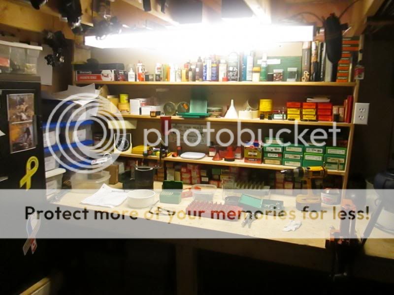

Here's my setup. The Dillon 650 is mounted directly to the table as my basement ceiling was too low to use a strong mount. I ended up having to put an addition leg directly under it to make it stable enough. I don't use a case feeder with the 550, so I had room to put it on a strong mount.
