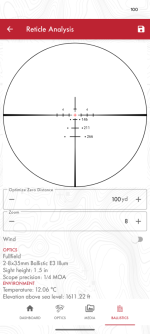

Here's the holds on my E3 reticle according to the Burris App. I may decide to order their custom turret for the 350.
I've always been interested in the E3 reticle and like how it's not a clutter when looking thru. It might not be 100% as for dead on but better then just guessing the hold over at long distance. Just a mater of practice and load development to make it work.
Also a lot of 350L seems to suggest a 150 zero. I can't do that on my range as I can't set up targets part way. Not allowed.
150 zero seems to allow minute of deer lung holding dead on from 50 to 200.
Seems that the holds on mine would be close enough to hit the deer out to 260ish using the BDC.

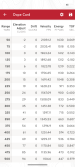

The app can also make a dope card for dialing, see below:
Couldn't you just run all your numbers through JBM, set the zero for 150 m, and then dial up whatever it tells you to go at 100 m?
Here's a quick example with a different cartridge
https://www.jbmballistics.com/cgi-bin/jbmtraj-5.1.cgi
