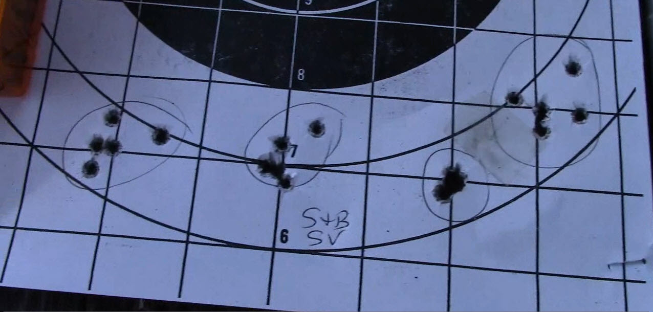

I can't argue with that. Here's some groups of S&B Standard out of my Rem 40XB.
Yeah, I wouldn't expect that performance there either. Those groups all look under an inch and well distributed, which I think is a great result from about the cheapest plinking ammo on the market. I haven't found anything else under the $60/brick range that's worth shooting out of the Annie at 50 yards, all of it had averages well over 1" and some up to 1.5". Anyway, neat result and good shooting.

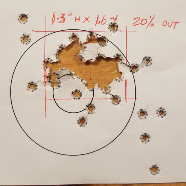

Ripped off a box into one group at 100 yards today, crummy conditions (5 to 15 mph gusting, 2c), but it's illuminating anyway. Most rounds go into a box well well under 2 MOA. The flyers there aren't wind, that's the ammo. Certainly not ammo you'd want to use for competition, but for practical accuracy with $4/box plinker grade .22, I think that's darn good performance. It compares favorably with four different lots of SK FN Basic at that range. For ammo that's half the price, I'll take it. It's enough to let you fairly reliably smash a clay pigeon out to 200 yards. What's not to like about cheap ammo that can do that?
Like I say, maybe I suffer from low expectations, but I wouldn't expect that from low end ammo out of a low mid range rifle.
