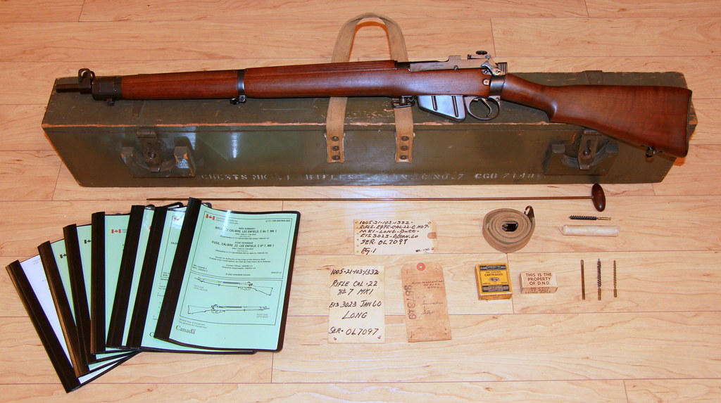

Installed a C No. 7 extractor in the SMLE bolthead. Direct fit, no alterations needed. Cut the extractor notch in the barrel breech. Started with a couple of hacksaw cuts, then went to work with small files. Test fired, extractor works nicely.
Ready to start external cleanup on the salvaged parts used. I was thinking about blasting and parking, but a lot of FTR'd SMLEs were painted. Might just go that route.
Basically what I will have is a rebuilt barrelled action in .22LR.
Now I have to decide if I want to install the .22 barrelled action in a restored SMLE I have, or go the route of finding all the parts to stock it up correctly. A nice SMLE stock and hardware set is no longer inexpensive...

Muzzle crowned, breech faced off, chamber cut. Used a match reamer. Converted a bolt head to rimfire. Drew back the hardness, drilled a 1/4" hole through, soldered in a 1/4" plug, faced both ends. Drilled an offset two diameter hole for a firing pin, made a firing pin to fit. Altered a .303 firing pin into a striker, cutting off the tapered tip, leaving a flat end. Test fired. No issues.
Next step will be to set up an extractor, and cut the extractor notch in the barrel breech.

The receiver now has a buttstock, and a I found a sported forend in my junk bin, so It will be enough of a rifle to test. To test accuracy, I've installed a Central base and Central No. 4 aperture rear sight.
If it shoots well, then I'll have to start the search for the forend assembly to restore the proper appearance.
