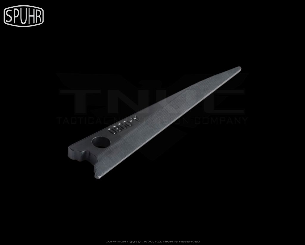

SPUHR mount showed up today, But now I have an issue, I used the supplied tool to install the scope. The mount shows level, I put a level on the turret that shows level and my crosshairs are tilted in the scope... WTF...
If the mount and turrets show level I wouldn't bee the rail that off would it ?
Was the wedge oriented correctly. I'm stating the obvious but there is a flat side and beveled side and they will not achieve the desired resust if not positioned correctly. Just saying.
Looking a little farther back from the eye piece does the vertical reticle line not look like it's pointing through the center of the rifle?
Could be a canted reticle. :( Hopefully that's not the case, because at long range you'll be all over the place. Wasn't like that with the previous mount?
Really lol...
Well then, What are you basing your opinion that the reticle is canted upon? Does it simply look canted from behind the gun or have you levelled the rifle and confirmed it against a plumb line.
I ask because I have a rifle scope combo that when you're positioned behind the gun, the reticle appears to have a slight cant however the reticle has been confirmed to plumb and it is simply a perception thing.
Will give a plumb line a try tonight. Didn't think to try that.
But the wedge thing is still funny. It only goes one way...lol
