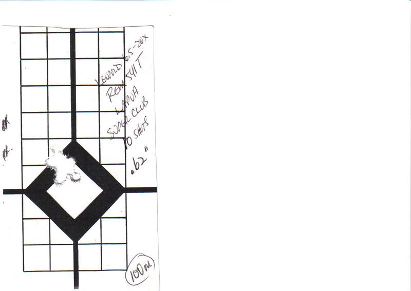

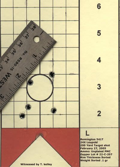

Achieving sub-moa groups at 100 meters with a 22 rimfire is not easy, even with the best of equipment. Consistent sub-moa groups are even tougher. However, a top-quality 22 with good match ammo and excellent wind/light conditions can be impressive. I will post a couple of my best groups at 100 and 200 with my 541T Remington. (yes, that 200 yd group is under 2"!) This rifle has been "tweaked" considerably, but still wears the factory tube with the match chamber. Regards, Eagleye

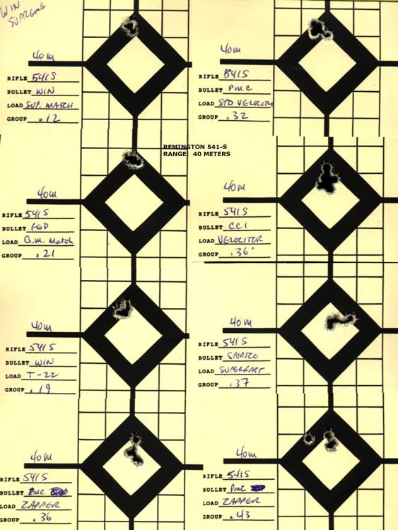

Bought a 541S (actually 2 of them) a while ago. Took one out to a short personal range and shot a few groups, mostly to see what potential was there. Here is what happened at 40 Meters. Match quality rfles DO make a difference!! Regards Eagleye
