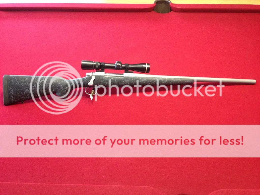

Here is a picture of D-man's 416x2 Remington 660:
Looks like a real cannon! And a very nice build, I have also uploaded a picture of the blind magazine conversion on the rifle if anyone is interested I can post it.
Missing my fav part though, the vent rib! (Yes I'm weird)
The reference to a .458 American twigged my interest in this thread, I too thought that would be an ideal big bore for close-range brush hunting, short action, short barrel etc. However, I had an idea that using the same philosophy with a slightly smaller diameter bore size might make the completed project a little more versatile. Into the Wildcat Cartridges of the World book I went, and found a reference to a .416x2", also known as the 10.6x51. Long story short, I now have a .416x2" built on a Remington M660 action, with a heavy sporter Montana Rifleworks barrel. 300gr. Barnes at 2250fps, 400gr Hornady's at 1800. As with any wildcat, there is a bit of bother making cases but the supply of magnum cases to make them is endless and I had CH4D make me a set of dies for a reasonable price. Just another option of many to consider....
That is a nice stock, can you tell us who made it ?
How about a 404 Jeffery? This is a cheap and dirty build... Rem 700 300 Rum action and B&C Alaskan Stock... Shoots unreal. And weighs 8lbs! Recoil is heavy but manageable...
Kevan, the stock is actually the original with a significant amount of re-shaping. It now has a blind magazine and an ADL trigger guard, and the stock was painted. It looks and fits much better now, I wish all the original 600/660 stocks were shaped like that. Mitch Kendall in Kamloops BC did the metal finishing and the stock work.

Kevan, you know how rare the 600 is in 6.5, if it was mine it would be hard for me to tear it apart and re-barrel, but at the same time finding a donor magnum short-action is also difficult. My 660 was a .308 and I had the bolt face opened up and a Sako extractor installed. Opinions on doing that are varied but it has worked fine for me.
If you want a fun build try a 404 Jeffery. Any RUM action or 375H&H action (if using 375H&H, feed ramp may need to be modified, and a couple of extractor cuts added) can be used. Add a custom barrel. Use Win M70, or RUM stock open up the barrel channel and away you go.
